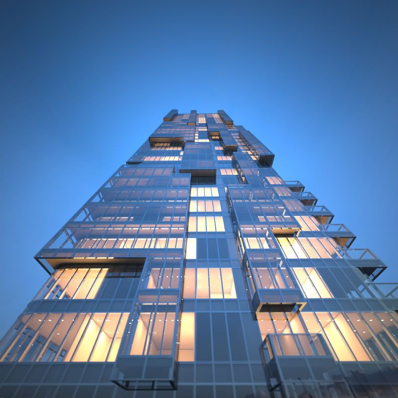

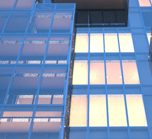

close up shows specles on the frames 3500 x 3500
overall view
first maxwell interior shot.
Image[/img]

Great exterior render. Are you using AGS from the wizard? Since you have interior lights, I would recommend it. It might clear faster. Also, you mentioned you are using HDR. How do you have it set up in your scene?
#286680
Are you sure the glass material is not refracting? It's an AGS type material? What is the metal like material for the structure, perhaps it's too reflective.
