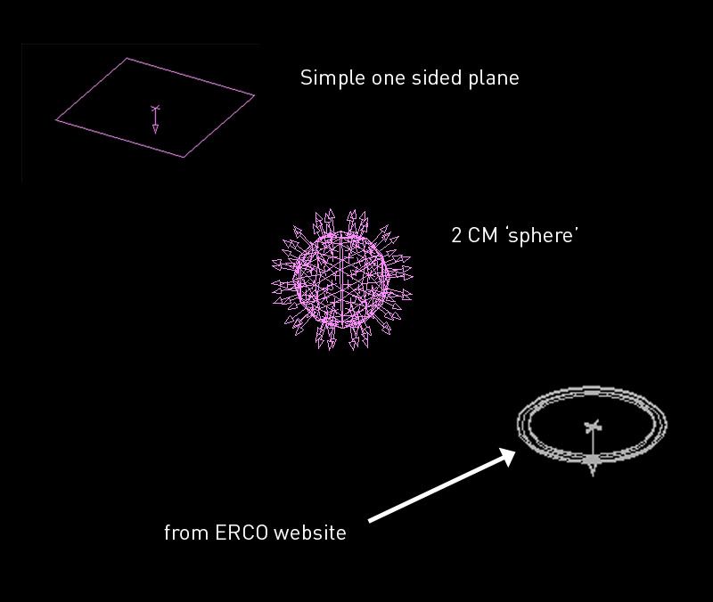

Ok the test is coming- i went to ERCO website and downloaded this
erco_compact_hit
a basic down spot. i got the 3ds data as well as IES the IES I applied to the circular flat objst that i assume is mean to be the emiiter surface in their 3d model. i then also applied the same emiiter material to a sphere and flat rectangle and am doing a maxwell render of all three.
ok, i just realised that i cannot attach an image easily here...so till i figure that out, i'll need to keep results to myself!!!
btw, all three work, but the light coming off the Erco 3ds geometry (it'a a flat polygon, maybe 20 sides) is giving off alot more noise during the render than the other two; I don't know if this is because there is a 'ring' around the endge in 3d space(part of the light 3d geometry i imported)... i'll have to test it without the ring object on.

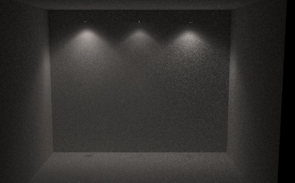

#341199
this is the multilite result in a white box(order left to right corresponds to previous post)
notice more noise on right(the 24 sided polygon)
Hey what's with the little spot shadows on the floor????? there is NO floating geometry to cast those- i assume a sort of artifact....

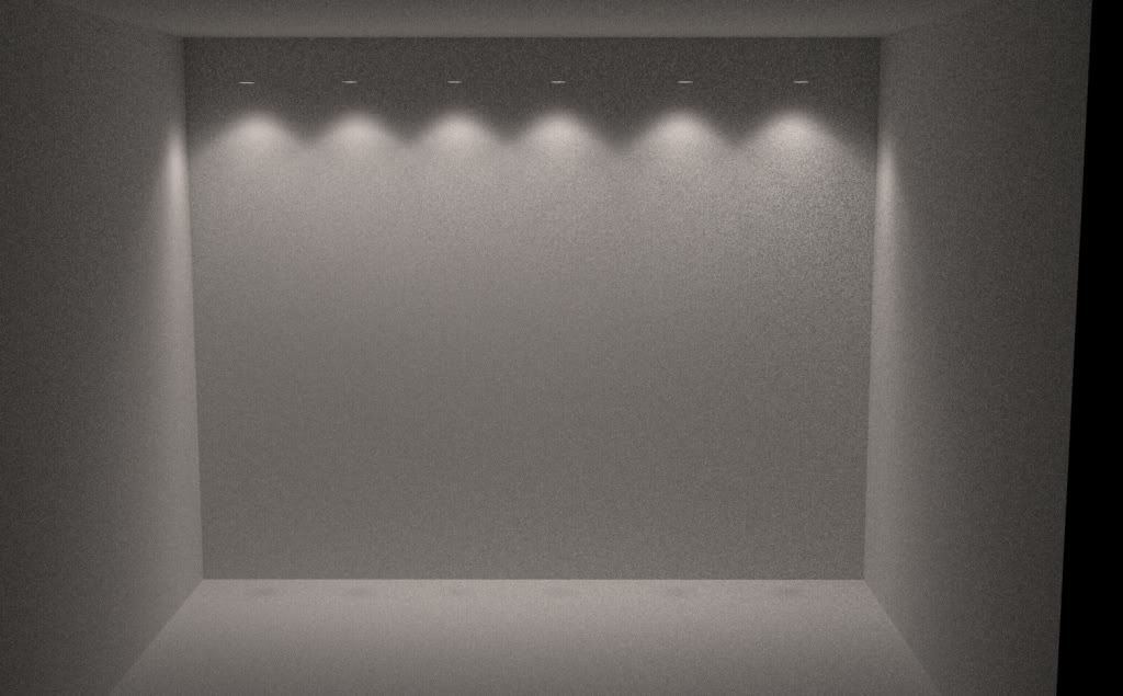

#341201
and just to show that i am trying to enter the testing maxwell spirit that Jason explicitly recommends, her eis a test of emitter polygons- they go from 3 sided on left to 22 sided on right progressively- no ring geometry, and the noise increase is clear ...
