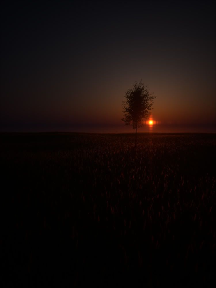

WOW Bubbaloo what an AMAZING image..
you can call it fire grass or something to that effect..cus WOW what an eye opener that grass is on fire!!!
I dont think the sss is too much cuz thats why to render to do an image that is hyper real!
wondeful V2 post!
Question.. is the grass geometry or thin planes clipmaped? using a randomiser? if its clipmaped then that Really shows some V2 power!

3dtrialpractice wrote:Question.. is the grass geometry or thin planes clipmaped? using a randomiser? if its clipmaped then that Really shows some V2 power!
It is not opacity mapped. It is just a piece of thin geometry scattered around a surface using Max's particle flow.
Thanks 3dtrial and rusteberg
