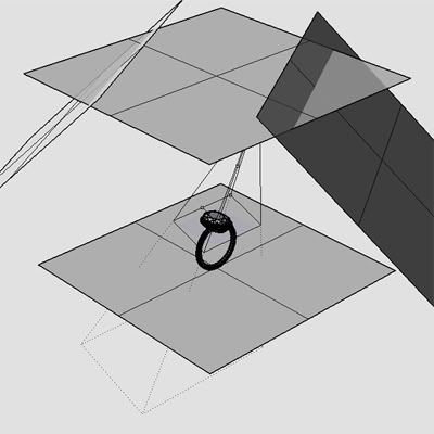

First time using displacement map on the rim of the collet to create kerning effect! :D
Both Rings were modeled in Rhino and rendered using the scene setup above. The scene consist of three emitter planes: Two for reflections/refractions and one diffuse only to light up the ground plane.
I've noticed that the scale of the model directly affects the DoF effect in maxwell, so I've scaled the model up 10x and set the F-number to 25.
Another item I've found is that mimicing standard product photographic techniques like using a "light tent" doesn't work so well. The results tend to completely "white out" the diamonds.

I used the diamond ior file for the stones and used the platinum ior for the band and structure. I painted a simple gradiant HDR in Photoshop for the emitter planes. The model is highly detailed and includes all the rounds and fillets so Multilight was turned on to adjust the lighting.

Great renderings! You could perhaps save some render time of you don't have intersecting emitter geometry.
ioiooi wrote: I've noticed that the scale of the model directly affects the DoF effect in maxwell, so I've scaled the model up 10x and set the F-number to 25.
This could give you problems since you are trying to render a diamond 10x as big as it is in real life. You could try moving the camera farther away from the ring and compensate with a larger focal length so the ring takes up the same amount of image space.
