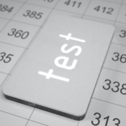

I don't know why, but I can't seem to wrap my head around something and I think I'm just not seeing something obvious.
I'm trying to do a very pure white plastic material with a seamless illuminated area, something like the picture, which was just composited in PS.
And that's cheating!
I would like to do it as a single material rather than creating 2 objects with different materials because there will be cases were I will have many, many objects illuminated.
If I use an MXI to create an emitter map layer on a material, it doesn't behave like I'm expecting it to, like a clip mask where black is nothing (showing the basic materials underneath) and white is the emitter. When I do that, I get a black surface no matter what the other basic layers are. So if I want a pure white as my basic reflective layer, I would need to have white on white emitter layer, and this obviously doesn't work.
If I could clip the emitter layer I would be set. But that doesn't seem to be an option.
Maybe the only way to do it is by compositing?

Take a look at the third page of this tutorial from Think! site:
http://think.maxwellrender.com/emitters ... p=2&lang=0
In fact you don't need to clipmap or weightmap anything. Just create the material of the thing when the emitter is off, just the white plastic. Then add a emitter layer with mxi texture of your letters. That's all.
Edit: As an additional note, when testing this materials from mxed change render system to RS1, as RS0 (default) won't display the emitter part correctly. In fact it displays black and maybe it is what is misleading you.

OK, so the only thing I don't get is when you say, "Then add a emitter layer with mxi texture of your letters", I take that to mean the emitter map is white letters on a black background, right? I'll try this in the morning and see what happens, I think that's what I'm doing. Perhaps I'm missing something I won't see until I do it step by step.
I'm currently using RS1, and I'll check again to see if I can find the actual .mxm of that tutorial because it seems like it might be the right direction, but I need to see the maps & settings to tell for sure.
fyi, I'm not interested in rendering anything in both an on and off (lit and unlit) state, just on.
Argh, it would be SO easy with a clippable emitter layer! I just keep thinking there's something simple I'm missing...
Right, sorry for my bad English.

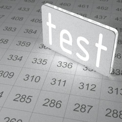

It's very easy. In fact this way there's no need to clip anything. Black means no light and shows the rest of the layers, the rest of the colors are light and show the rest of the layers depending on the intensity.
Take a look at this material:
http://www.ftella.com/links/Plastico_bl ... minado.mxm
The two BSDF layer make the plastic material, and the emitter is just an mxi texture (white 2 over black background)
Eeeeasy.
Good luck

No Cary, the material I posted is meant for one mesh and one material. Just apply that material to a plane and everything should work ok.

Yeah, Fernando, you were right. I don't know what the problem was before, but I think it must be something to do with the mxi I created for the emitter.
I guess that means anything other than rgb=0,0,0 on the mxi used for the emitter map is going to be seen as an emitter. So maybe I had what I thought was pure black (which will act as a clip and show the underlying material) was just very dark grey, and just appeared black to my eyes. That's the only thing I can think of, because no matter what my underlying material was before it came out black.
I'll have to experiment a little, because I'm not really sure how the settings in mxcl effect the mxi it creates. I was just opening a tif and saving as an mxi.
