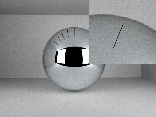

Long story short : I have a product visualisation that really visually suffers from the ol' energy loss on the corners of an reflective object. That means the bigger the perpendicular angle to the camera is the less bright the reflections are which is something like an inverted fresnel. So nowhere near physically correct :D Even my customer pointed that out :D
So my question is when will NL guys finaly sort this out? Alot of unbiased renderers have sorted this out eons ago so is it even on the future maxwell roadmap?
A sample image of a phenomenon that makes our images a bit more ugly :

I think your test is flawed...
I don't detect any loss here - the only difference is the sphere's material.
By hyltom
#277405
I suppose your material is some chrome, so how it can reflect something more bright than its environment? I really don't understand where is your problem...at least in this test.
#277406
It looks like a reflection of the environment to me. If the environment was white like JD's then there would be no gradient edges. I used to have a pinball somewhere. It would be interesting to set up a physical model and take a pic to see the result.
#277412
Hybaj, what you see on the grazing angle is the reflection of corner of walls which are naturally dark by GI. Nothing is physically incorrect here.

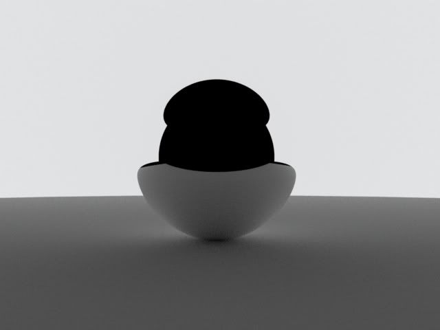

For the last couple of months I've been doing my own research in which I invest alot of time, money and work before I enter a specific metal working business with my own company. So these days I do alot of sanding and polishing of various metals and metal alloys up to 2000 grit (that means damn shiny). So let's say I have a pretty good idea how the metals reflect light. But that's not really interesting :)
Let's get down to the pictures
Now there's no lame-like background (i was in a hurry last time so I didn't really give it much thought) and you see the effect is pretty strong even if the background object is an emitter so it has a flat color everywhere.
But it's because of the ND which is 20 (even the wizard presets for metals use an ND of 20 which is pretty incorrect judging from the top picture) Gosh I wish I could see the ND visualised in an Curve.

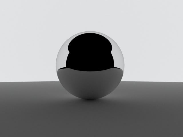

With full silver IOR file. No darkening of the edges.
So what's going on here? How does the ND curve look like (reflectivity Y axis, angle X axis) ?? Why is there a drop in reflectivity on the edge's angles?

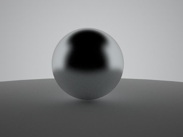

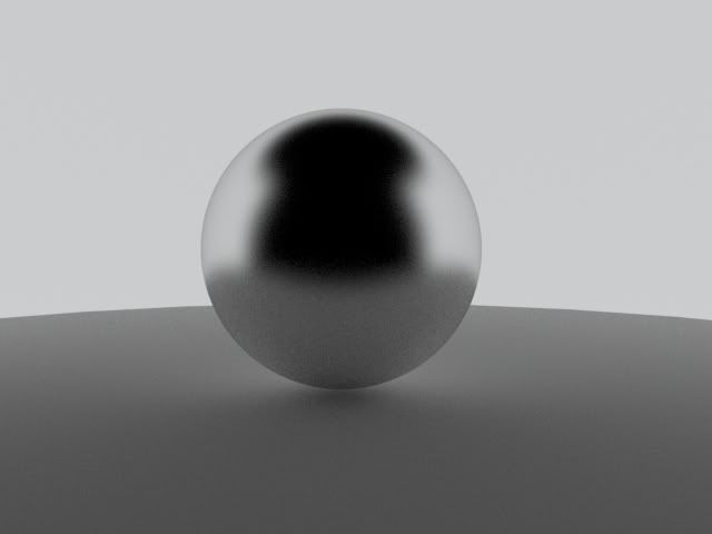

Now that was ND... but here comes the roughness (didn't have time to cover it in the last post, had to go lathe some metal things) - dark edges even with full IOR or 1000 ND
Full IOR (silver IOR.. the same as in the last post)
1000 ND (a slight bluish tint because of the aluminium preset from wizard)
So here's the fabled energy loss which hasn't been resolved in Maxwell. It's a small effect which is hard to see in many scenes (due to things like in my last faulty scene) but sometimes (as in case with my product visualisation) even a customer can point that out (a crazy laser-optics guy) :)
