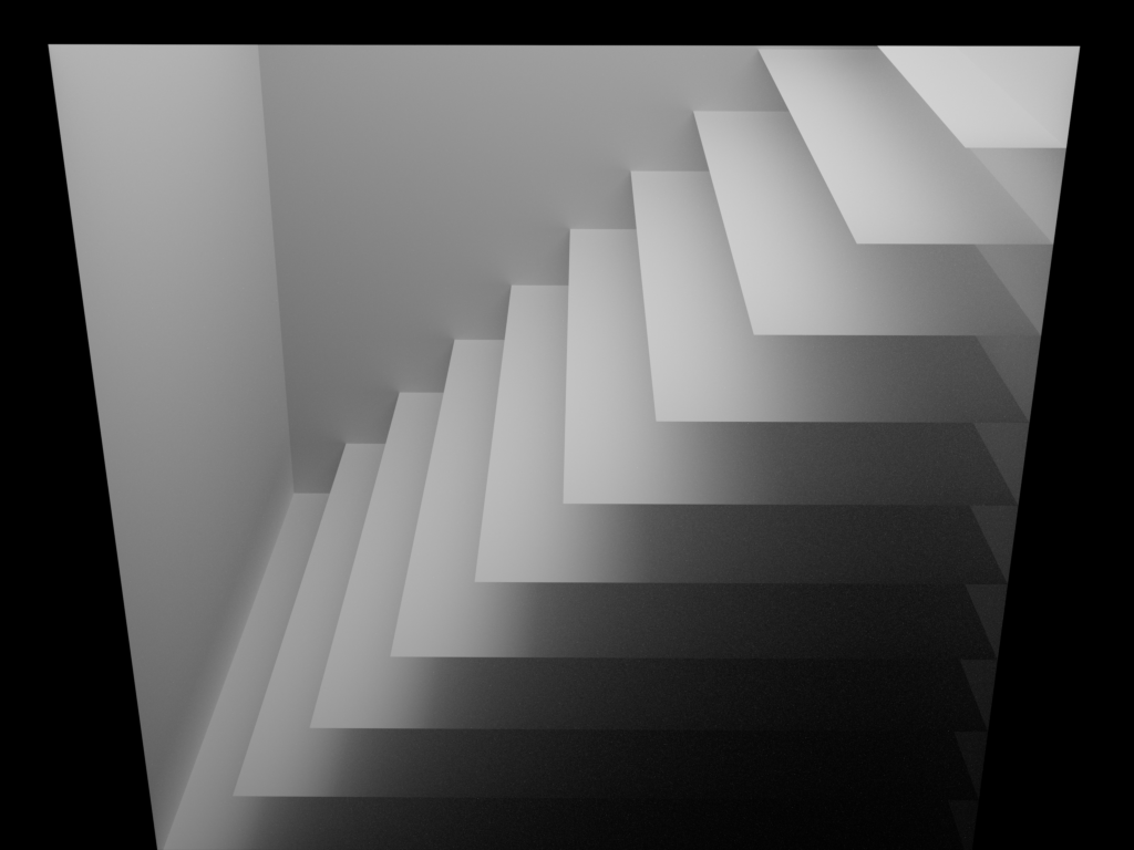

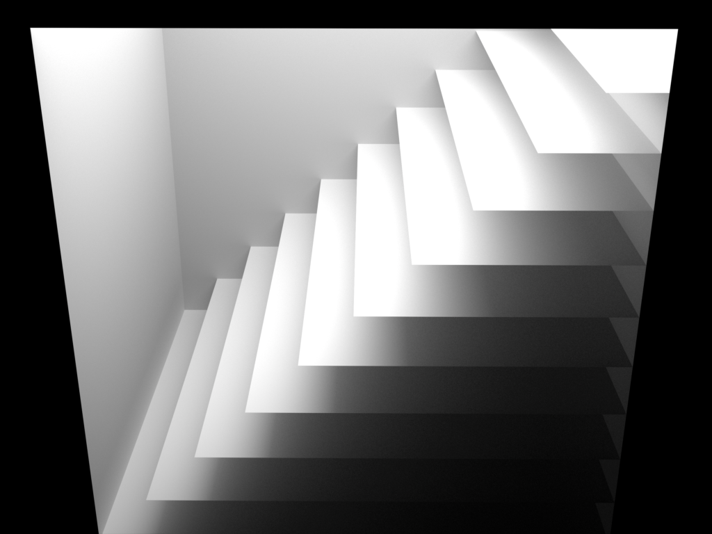

I'm working with SJ's original test scene and doing a sequence of renders using different materials. In the process, I came across something that nicely illustrates some stuff that's been said here many times.
Both of these images were rendered in V1. Both have the exact same camera settings. (ISO 1500, shutter 15, fstop 200 [hey, it's what SJ had in there], burn .8, gamma 2.4, auto-exposure).
One image has a uniform material setting of RGB 230,230,230 and roughness 90. The other is RGB 200,200,200 roughness 90.
Can you guess which is which?
The answer is that the second image has the higher color value. It's darker and it took about 30% longer to reach the same SL as the image with the lower value texture.
So, the moral to this little story is: overbright textures REALLY, REALLY do slow down renders, make them noisier and generally provide poor results.
Ideally, I'd really like a checkmark on materials for 'clamp to legal values', but it ain't that hard to remember to use legal values.
By DELETED

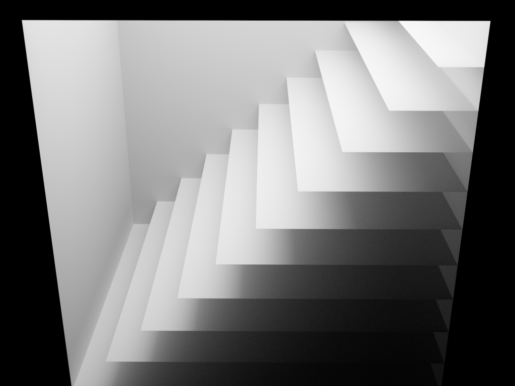

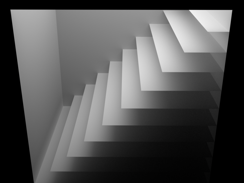

Material 200,200,200
Material 230,230,230
No auto exposure. The difference is even more pronounced.
By Voidmonster
#164846
The 230,230,230 one was rendered a couple of days ago and I don't remember the full specs for certain, but what I recall is that it took 20 hours to get to SL 19 before the noise smoothed out while the other lost noise by SL 18.61 in about 11 hours.
I wasn't keeping close track of SL/Noise/time stats since that wasn't really what I was testing... This was just an interesting indirect result of my primary testing. :)
By Voidmonster
#164848
The only difference between the two renders are the color value in the materials setting.
