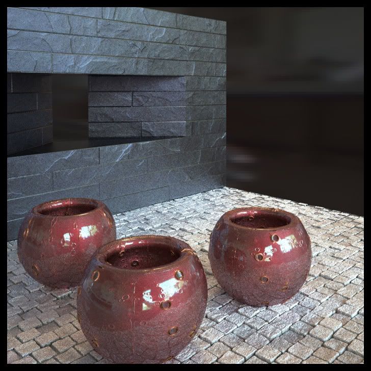

KurtS wrote:another quick test:
wall is bump only.
floor and jars are with displacement.
That floor totally rocks!!
any chance to see the displacement map?
