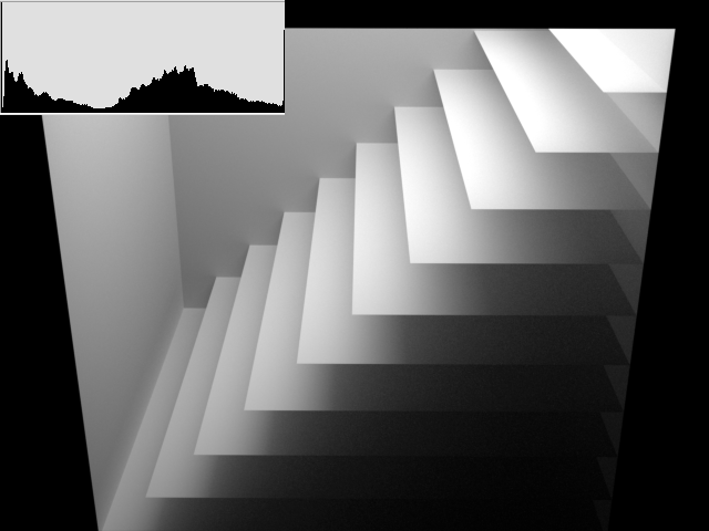

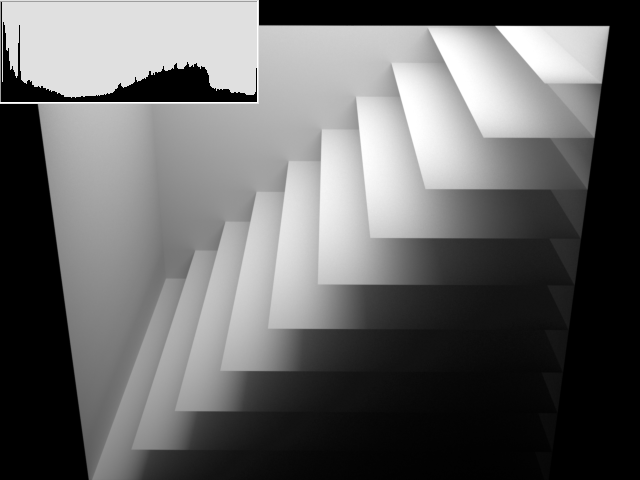

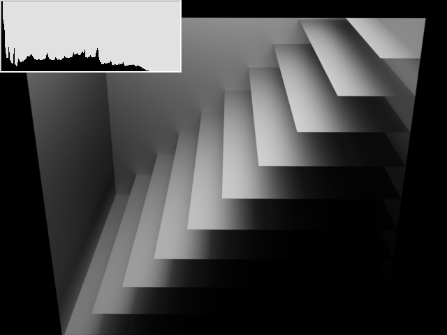

Lambert material, Benchmark 50.96, Rendering time 4h56m44s
Roughness 99, Benchmark 61.16, Rendering time 4h07m15s
Roughness 90, Benchmark 60.76, Rendering time 4h08m50s
Roughness 50, Benchmark 48.41, Rendering time 5h12m20s
I'll post the analysis in a separate message.
Roughness 10, Benchmark 61.36, Rendering time 4h06m25s
By Voidmonster
#165506
In my test, beyond a certain point I didn't try to match SJ's original Beta image. The results I was getting suggested it would be more fruitful to do a comparison between V1 images with different settings.
Here's what I did and what I found.
I chose 7 points in the stairstep image, in roughly the same areas as SJ. I marked down the pixel coordinates of each of the seven points and then used the 5x5 averaged eyedropper to obtain a color value.
I only performed this test on the Lambert, Roughness 99 and Roughness 90 images. Here are the results:
La | 99 | 90
1 - 79 | 105| 95
2 - 57 | 76 | 67
3 - 40 | 55 | 47
4 - 28 | 39 | 32
5 - 20 | 28 | 22
6 - 17 | 19 | 17
7 - 11 | 16 | 12
To make more detailed comparisons to the beta image, I would need the MXI file in order to match lighting levels more closely. However, I think so far this test clearly shows that fairly significant changes to light distribution happen as a result of material differences. Note especially the difference between Lambert and Roughness 99.
