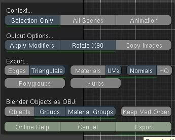

I sometimes imported successfully a 2.1M poly and sometimes not. Never more than that. Could you tell me the export settings you use in Blender?
This link shows you a screenshot of Blender OBJ export dialog. If you could tell me what do you select it would be very kind of you as you say you've been using the Blender/Maxwell combo for a long time.

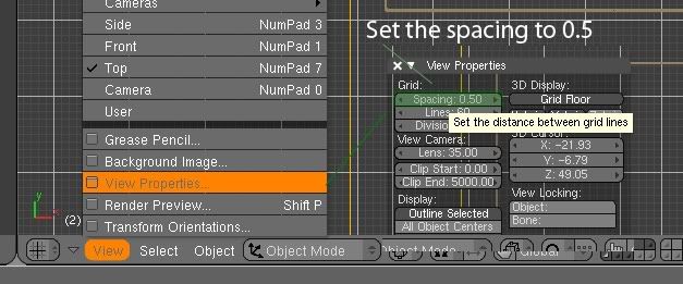

Sorry too for my late reply. Here is the OBJ export dialogue from Blender 2.49.2
I've highlighted in Blue & underlined in green, the settings I use for all obj exports.
A couple of things to remember for correct scale & correct export of objs for use with MXST.
1.> In the header for each 3D viewport you have, click view, then view properties. Change the Spacing to 0.5 for each viewport. This will give you a 1mx1mx1m cube, when adding a new Mesh>Cube. When exported this will be a 1mx1mx1m cube in MXST. Any other spacing value will give incorrect scale in MXST.
2.> Make sure though you don't have a camera selected when you export.
If you do the Spacing change when you start Blender without loading a scene, you can save these settings as the default for all new scenes by pressing CTRL+U.
If you still get a crash when exporting, you'll need to export sections of your scene seperately, it may be a RAM issue.

Thank you!
I had found some ways to export but the scale trick will help me: I often import a huge sofa :? and then scale it down in Maxwell. I think I can avoid that with your trick.
