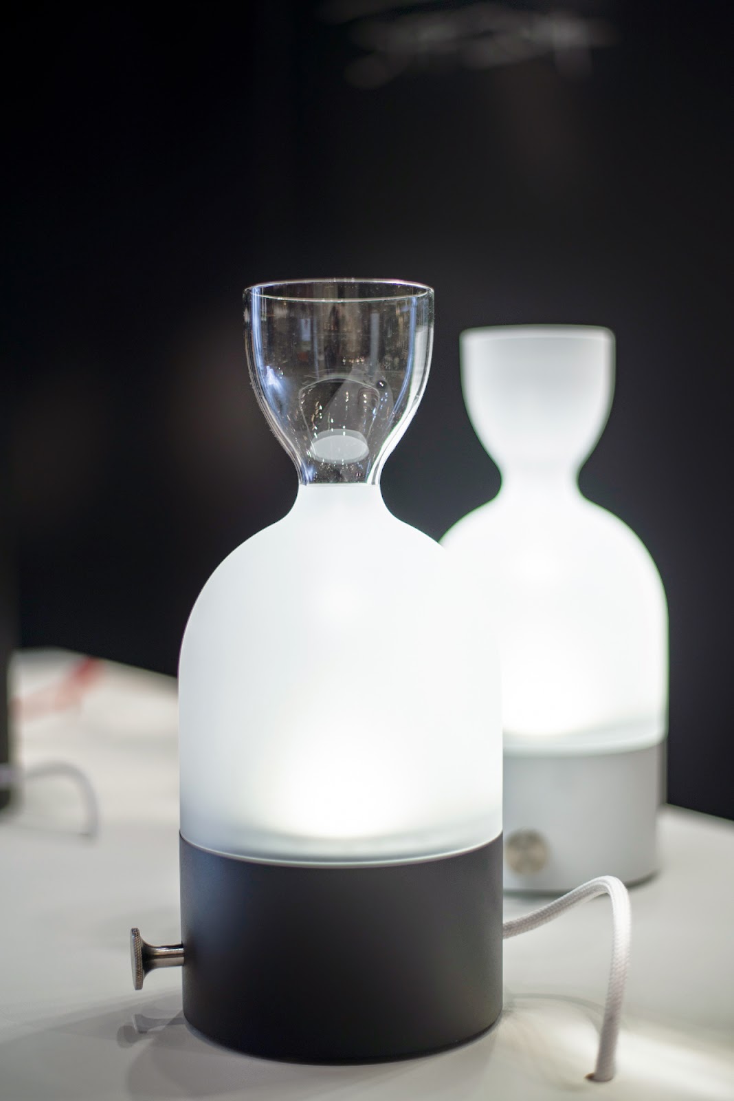

#382381
Just to finish this old thread off, the oddest thing occurred: On the actual object, the light "floats" as the rendering shows, even though the emitter is buried http://3.bp.blogspot.com/-puTr7Sr1Kzk/U ... lights.jpg
Must be a most peculiar reflection/refraction having to do with the glass shape. Well, at least that tells me that rendering an IES emitter with Maxwell does actually work realistically, which is important when developing luminaires ; )
