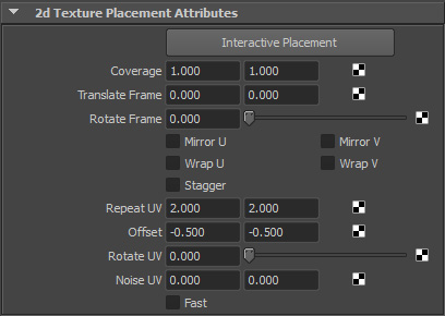

I found out I was using incorrect settings for the offset in conjunction with the wrap settings: it is possible to render a displacement of a texture confined to a smaller area.
However... because of Maxwell default settings sets the area out of the texture to zero (when Wrap settings are off), it means it can be only used when displacement maps are used with the offset set to zero as well, which means also I can't use what I got since I need negative displacement...

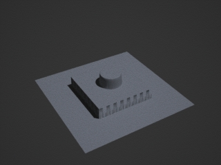

Here is a render of a plane using an image of a white dot over black with default settings:
Here are the texture settings I'm using to turn off texture wrapping and setting the image to the center:

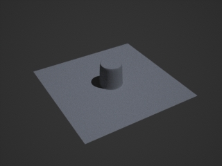

Which this results in this render (nice!):

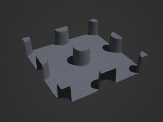

However using a white dot over gray (with the Displacement Offset set to .5) results in this render:
A you can see outside the boundary of the texture Maxwell sets the Displacement value to zero: it should set the value to the same value as the Displacement Offset value instead, or even better set the value equal to the Default Color set in Maya.
#331434
gianca wrote:A you can see outside the boundary of the texture Maxwell sets the Displacement value to zero: it should set the value to the same value as the Displacement Offset value instead, or even better set the value equal to the Default Color set in Maya.
Non-wrapped area is equal to offset level already. It still pushes up the grey color (in fact, it pushes down the black off the UV) in the texture because, offset is relative to geometry, not to the given color. But, I understand you're trying to set the color of non-wrapped area instead. Not all applications have the same thing with Maya, so we should add an additional parameter, here. Instead you could shift the texture colors down and easily sort it out. ;)
