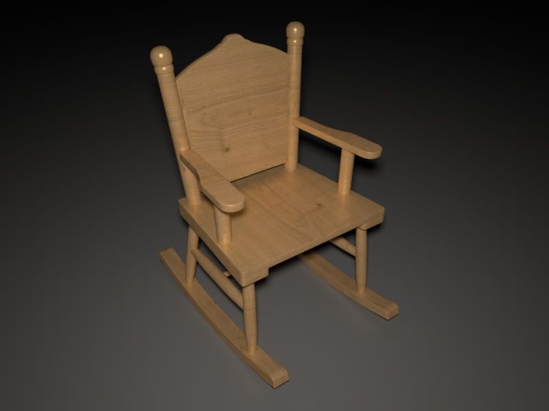

Are you comparing time and noise? You should be. Benchmark and sampling level differences between 1.7 and 2.0 are irrelevant.
Here's a quick test from me:
1st one is V1.7.1 @ 1 minute, 2nd one is V2.0 @ 1 minute:
V1.7.1 is noisier at 1 minute.
1st one is V1.7.1 @ 5 minutes, 2nd one is V2.0 @ 5 minutes:
V2.0 is noise free, while V1.7.1 still has noise that will take quite a bit longer yet to clear to the level of the V2.0 render. I will keep rendering the V1.7.1 scene to see exactly how long before it reaches the same noiseless clarity and report the time. I'll also set up some more tests.
