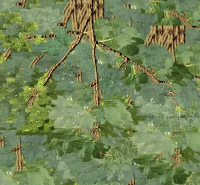

and thats the branch texture:
-Micha

FryRendering by Arscom Studio on the front page doesn't look bad at all.
Anyhow you could make tries like that with Xfrog and onyxtree.

Thanks for the hints for Xfrog and Onyxtree. I forget to say, the VB Visual trees have max. 8000 polygons. Are the evermotion trees low poly? My experience is that evermotion models are quite high poly.

With Xfrog you get XfrogTune, is used to reduce the complexity of branching structures of trees.
For lowpoly Vue and assets from cornucopia3d is the best solution :wink: Vue 7 Pioneer 0$ + Exporter $149= 8) but I have not idea how it will work with Rhino. Work ok with "others"
