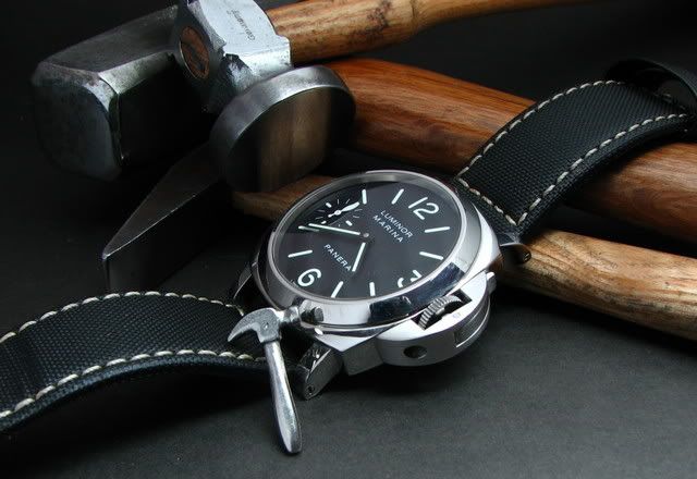

This is a shot I took using that file box ($5) and then lighting through the box from the outside with 2 halogen lights from Walmart ($7 each). I suspect that lighting through SSS might give the NL guys a seizure :)

Thanks for the image Cary, it has some info in it i can extract and use in my tests for this type of setup. Heh, your setup is defintely cheap, but it works pretty well except that i'm missing some reflections on the glass surface of the watch. Hehe light through sss is a nightmare, i won't go down that road wit this setup. It would make it impossible to use with unrealistic rendertimes for both engines. It might be something i wanna do for the studiosetup in Modo 401 as it will have a superfast sss solution. :)

Hey Maximus- no sweat- the watch crystal is a 3.5mm thick piece of domed synthetic sapphire with an anti reflective coating on it :).

That sounds like a pretty expensive watch Cary :) the anti-reflective coating definately explains the lack of reflections on the glass. That i didn't think of until you mentioned it.
