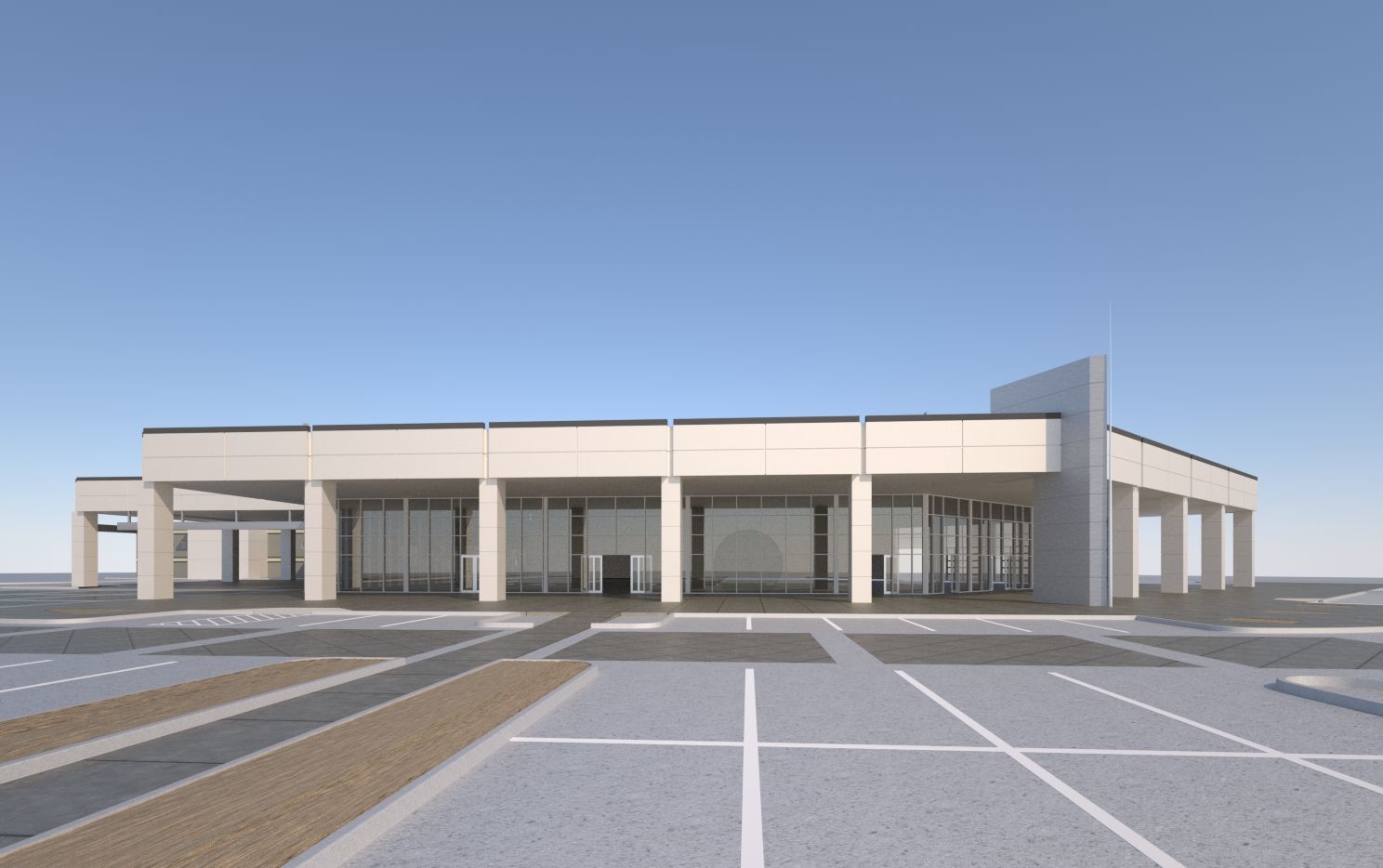

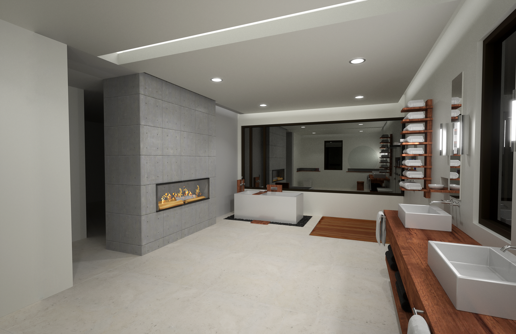

I have seen this is several of my images in the reflections. Interior and exterior. You can see it in the windows.
Any ideas?

it is a simple 1" thick pane with ags. It justed started doing this on my last few jobs using form-z. I have not noticed using Blender though.

my guess is (I don't know your software but) that maybe a clip plane in the camera settings is causing that. like it's clipping the surrounding sphere and you get a circle in the POV.

Sorry, I have not checked this post in a while. I have not tried to sove it. I will do as Tom says and see what happens. In the mean time I finished the project in Blender and everything rendered fine. No circle. So....It was only doing this in Form-Z to Maxwell Render.

I don't think its the glass, I have had this as well.
I am sorry for mentioning this as I do not know what causes it but I have noticed this appearing on my renders before.
Are you using c4d? Strangely I have noticed something similar occurring to my stitches in ptgui which is just bizzare...
does this occur in fire?
