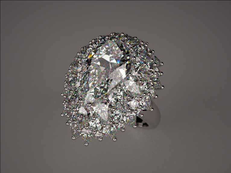

For starters I know my renders need a LOT of tlc so criticism is more than appreciated. My point for this post however is because I can't for the life of me figure out why the background is always grey when the material I choose is usually and in this case white???? I can never get a white ground plane...ever? Is this something that is supposed to be done in photoshop and can not be achieved in the rendering???

That is an old way of making that type of material and one of the drawbacks is that the color always turns grey.

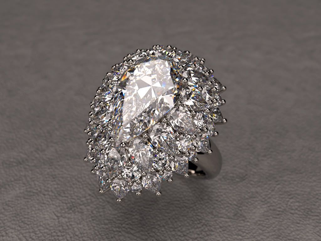

Here's a better version -- I used displacement because it will look better for a closeup shot like you have (although it will take longer).
The scale is set to repeat the texture every .5 meters -- which means this is a "realscale" material... as such it should be applied to a groundplane with a 1m x 1m projector (Normalized UVs in Maxwell Studio).
If you have any questions let me know -- and I think we'd all like to see the render when it's done :D
Best,
Jason.

Half Life wrote:The scale is set to repeat the texture every .5 meters -- which means this is a "realscale" material... as such it should be applied to a groundplane with a 1m x 1m projector (Normalized UVs in Maxwell Studio).
Jason I can't seem to use your material? I have it on the desktop in a folder and after selecting it from within the material browser the following pops up.
if I select "keep as mxm reference" and apply it to a 1x1 ground plane from the library the ground plane disappears and if I hit render anyway this is what I get Image
and if I click on "embed in scene" and drag and drop the material on the plane, this is what I get
so I click on "yes to all" and this is the 2 min render I get
(STILL GREY and there is no texturing to be seen on the ground??)

About referenced materials:
http://support.nextlimit.com/display/ma ... +Materials
About using Real Scale materials:
http://support.nextlimit.com/display/ma ... +in+Studio
Material FAQ about missing textures (FAQ nr 1)
http://support.nextlimit.com/display/kn ... erials+FAQ
Basically that material is not able to find the textures it's using, maybe because you put the mxm on your desktop and in that case it can't find the textures in the 'textures' folder that should also be on your desktop. Easiest way is to just put that mxm in the 'textures' folder and Studio will automatically look for textures in the same folder as the MXM. There's more info on that FAQ page.
A tip, if your object is so small, you can make that plane a lot smaller - and bring the emitters closer too, it will make nicer contrast.
