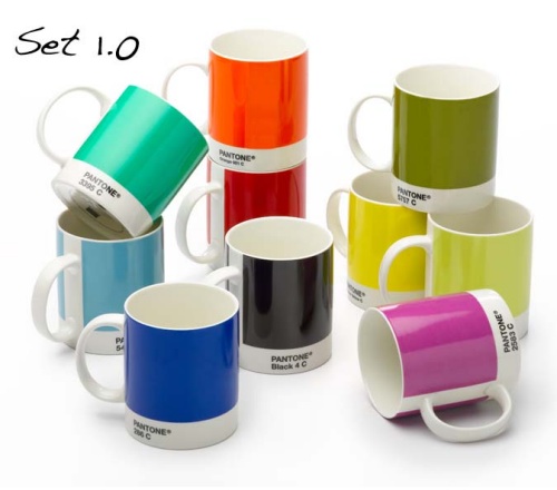

Here's a render with the generic white ceramic. I still think it looks way to dark in the cavity, if you compare to the following images:
By Half Life
#345751
The first photo has a strong down-light right into the inside of the cups -- you can see that clearly by the shadow underneath.
Set up similar lighting and see if you can compare apples to apples.
Best,
Jason.
By bLAZER76
#345753
Yeah, that's true. And it will probably look better if I also do that. But if you look and the second photo, that doesn't seem to be the case. I mean my first image is light up very much and almost black in the cavities, while this last photo has a pretty dim light and still looks brighter in the cavities.
