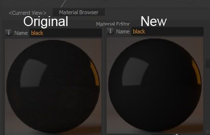

#333324
Your first material called "black" is semi transparent. I don't think it's supposed to be, since it is applied to the floor object. If you have 2 layers, both set to normal blending, and the opacity is set to 80 for the bottom layer, and 20 for the top layer, the result is 80% opacity. You should set the bottom layer at 100 opacity. Then add your transparency to the top layer to blend it with the fully opaque bottom (base) layer. Also, it's recommended to avoid 100% roughness for more natural looking materials. I haven't really looked at all of the other materials, but if they are like this one, that will be a large part of your problem.
