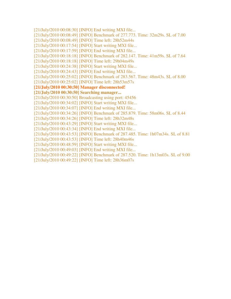

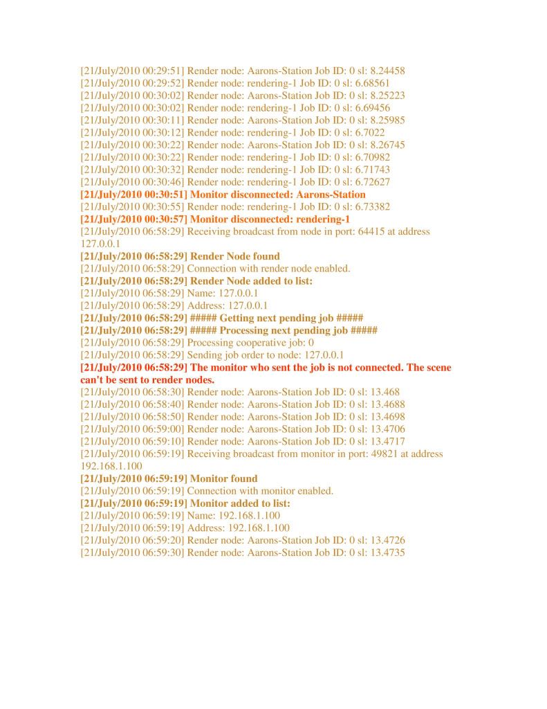

#327098
I have downloaded and installed the latest version of Maxwell and the Form-Z plug-in. I ran a coop and here is what happened, see images of manager and node below. I still can't run a successful coop. Not sure why the manager still is getting disconnected. I never clicked preview either, so that is not it.
If you see below, it shows the monitor reconecting but only processing the information of one node in the monitor. The other node is still rendering, which is great, but I wish I did not have to always manually merge my files. If I had a larger network, this would be frustrating. Anyway, I am not sure what is causing this.
I am not coming close to using up my ram on this job, so that is not it.
Could the computer going into sleep or hibernation mode cause this? It always seems to happen after I go to bed. Look at the times in the node dialogue. I turned my monitor just about the time it reestablished the connection 6:58am. May be coincidence Not sure.
Any helpful insight appreciated.
