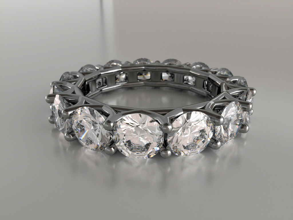

here is the example at SL 9

Here is the final render, and to be honest I'm not happy with it at all. No ones fault but my own as I'm a nooby to maxwell studio but disappointing none the less :( The diamonds are dead and the metal is just, well, grey.....
SL21

I had replied in a rush,
correction: I use ISO = 400 & IBL (not LBL)
the file you sent me had environtment off, so your hdri was not lighting up. use key K on the keyboard to swith on/off. looking at the environment set up on your studio, at your background, set the the hdr file you need, and you will see there apply to all (not copy to all
as I said) you will also see offset degree to rotate your hdri there
for the diamonds & platinum color, check your emitters temprature, I use at 6500deg
sorry for the confusion, hope this helps
