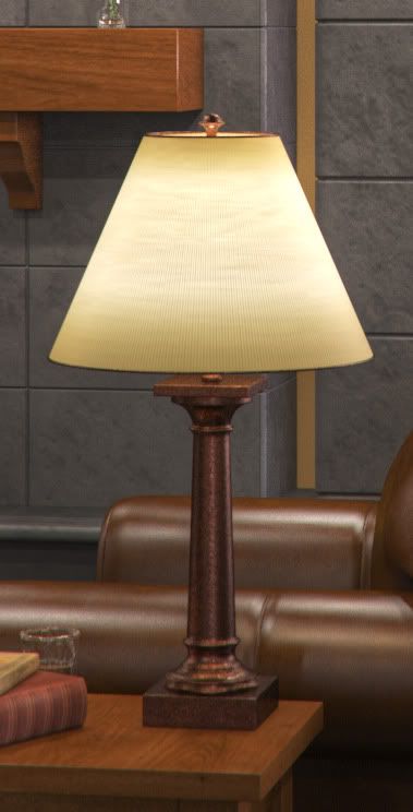

I've just got hold of Maxwell 2.5 (previously on v1) and I am trying to get to grips with SSS. I'm particularly intrigued by thin SSS as a way of creating a realistic lampshade material. See the image below:
Here the shade comprises two thin layers of different materials bonded together. The outer finish is a finely textured fabric and the inner surface is smooth white coated paper (or possibly PVC).
How should I model the shade - as two separate surfaces or as a single surface with no thickness? Then how should I assign materials and SSS so that the lampshade "glows" as it should?
This is all new territory for me so any pointers would be fantastic. Does anyone have any example renders and/or material settings that they have used in the past?

#334518
Thinsss will work very well for this, you can just model a single sided surface. Some examples and material settings:
Scene also has two emitters to illuminate the lampshade a bit.
Material:
The asymetry will allow you to control how diffused or focused the light is that's coming from the other side. Negative asymmetry will let most light pass through without scattering back towards the inside of the lamp shade (towards the direction of the incoming light), giving you a more clear transparent look. With positive asymmetry you'll get less light pass through the lamp shade (it will instead scatter back towards the light bulb) but also diffuse the light more. So if you want a more diffused look set asymmetry to something around 0 and also you could decrease the thinSSS thickness and/or increase the transmittance distance to compensate for less light going through the lamp shade. Here I also used a canvas cloth texture for refl/trans/sca colors. It's not necessary though to use a texture for tran/sca, but could give a bit more variation in the look.
Here with asymmetry to -0.1 (instead of -0.5) and thickness 0.3mm (instead of 0.5mm):

#334524
Mihai - Perfect! Thanks for explanation, the asymmetry settings are very interesting, something I didn't know about. Did you model the shade with thickness or is it a surface with zero thickness? Also, if I added another surface to the inside of the shade with a white finish and the same SSS settings would the lampshade effect still work? I'll try it out once MaxwellZ is working again.
Zdeno - Looks great. Are you using the same method as Mihai?
