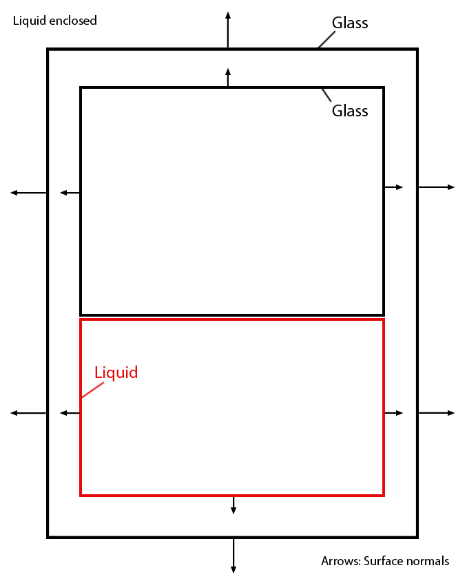

I need to do a liquid (opaque) in an enclosed glass box.
Is this what i need to do? (See below for the image)

That looks right to me except I think you need to flip your normals on the inner glass wall.
As for lighting, I'm not sure for dielectrics but SSS renders best with hdri lighting.
#329243
I would remove the part of the glass where it meets the liquid (at the top) and reverse the normals of the inner walls of the glass. Otherwise you might have issues with the coplanar faces between glass and liquid, or even if you have a tiny gap between them, Maxwell will take it as air and so you'll have a glass>air>liquid interaction and you only want glass>liquid.
