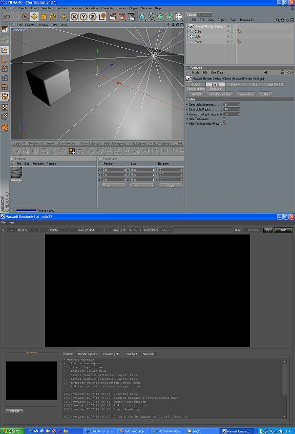

I just did a small test with a default omni w soft shadows, and in C4D it renders out fine, but in Maxwell it comes out completely dark.
Am i missing something?

Yep, that´s precisely the procedure i tried. Comes out as shown here.
Perhaps it´s a scaling issue. I´ve never used emitters with Maxwell before, so i´m pretty sure this one is my fault. :)

From what I can make with your screen grab it maybe that the 100 radius of the omni light is too big so what you are seeing is the inside of the light (which will be black because of normal direction). Lower the radius in the maxwell panel and see if that helps.
For noise reduction purposes it may also be worth reducing the number of segments that the omni lights get converted too in the Maxwell panel.
If you still have problems then 'plan b' would be to apply a maxwell emitter based material to a suitable low poly' object and use that as a light source.

You actually nailed it. The radius was the problem.
Thanks a lot Becco. :)

If you go into the plugin default settings, I normally set my sphere radius to something small like 0.5 inches. A radius of 100 is really to large for most type scenes as was mentioned.

0.5 sounds about right. I ended up using a light radius around 1, but going even lower would probably give a better result.
I realize the values are scene dependant, but at least i have something to start with.
