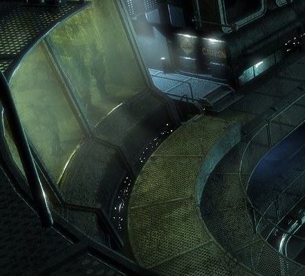

By Rochr
#202286
Tyrone, if you look at this example here, especially the walkway and windows.
This is how i apply dirt to a texture using the diffusion channel, and pretty much what i would like to be able to recreate for Maxwell.
