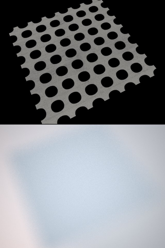

Since NL has stopped responding to error issues regarding the plugins, i though i´ld ask some of you here instead to see if you´ve experienced the same thing, or if it´s just me beeing totally lost.
With the newest Cinemaxwell, the renderer is supposed to render out the active viewport, right?
Well, the problem is that whenever i make a new scene using the 1.1 plugin, it renders out as it should once or twice, then the camera seem to loose focus completely.
At first i though it lost the tags and rendered out a blank sky, but after testing it a number of times, with the same result, everything just seem to get blurred to hell.
This scene here for example. It´s a plane object 5x5 m. The top image is what it looks like in C4D core, the bottom image is the exact same object rendered with Cinemaxwell, using an MXM.
No matter what you do, this is what you get. The same scene rendered in 1.0 (with 1.0 tags and MXM´s) with a camera, work without problems.
I´m also attaching the scene if someone should want to check.
http://www.rochr.com/Cameraerror.c4d

If you don't use a target object for controlling the focus, you have to go in the depth tab of the cinema camera and active front and rear for controlling the center focus (maybe only rear :?: ). Remember to set 1 in the unit moltipyer in the first tab of the cinemaxwell ;)

Thanks for the help guys. Appreciated.
goncalo, the camera was merely a test to see if it would work better. The reason for increasing fstop was because it has helped before to bring focus on objects. The rest is default settings.
I tried beppeg´s suggestion to see if it would work here.
Now i actually do get a clear object. Also tried with a camera target centered in the object but got no object at all.
This seem to do the trick, but by god it´s a completely idiotic, not to mention time wasting way to set up a camera.
