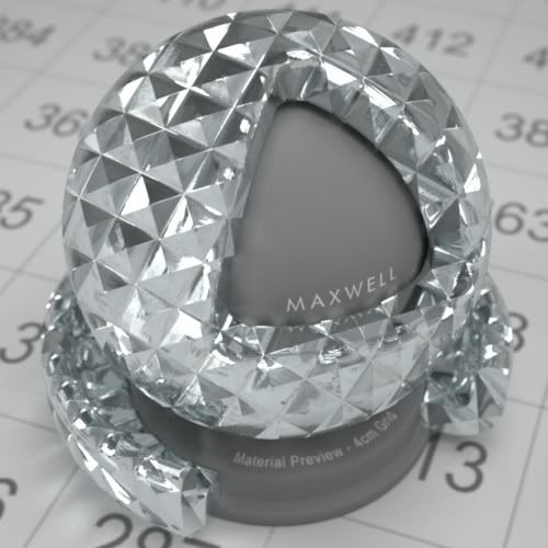

I'm trying to make a diamond patterned knurling material, like described here: http://en.wikipedia.org/wiki/Knurling
tests:
I guess that a normal map is better than a bumpmap for this kind of surfaces? I'll try to tweak it a little bit before I decide if this could be uploaded...

Very convincing and quite useful material KurtS.

Looks good to me too. I'll look forward to seeing it on the mxm - and to seeing what it will look like when the displacement function hits the streets!
