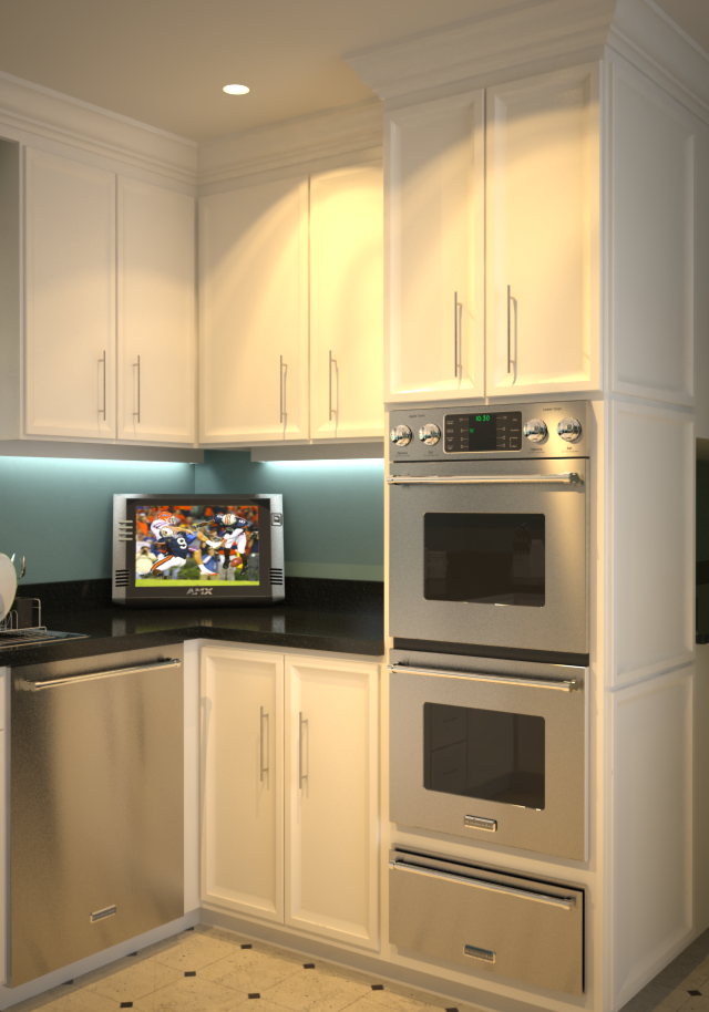

I haven't posted a project in a long time. This is a kitchen renovation I am working on. Comments and critiques are always welcome. Modeled in Sketchup 6, rendered in MW 1.7.
Justin

It looks great!!
But i think you have to do something about that TV screen. It's to bright compared to the hole kitchen.
other than that...just beautiful!
Jonathan

Looking good, but who has a TV in their kitchen? Sorry but it looks kind of tacky. :wink:

Hey guys, thanks for the critiques. Making adjustments as we speak.
I know at least 10 people that have tv's in their kitchen. This client specifically asked for a tv in the kitchen.
Justin

It's just that there's that white backlight present in the images, especially in the first ones. Don't know - is there a widow/door behind?
BTW, did you model the whole thing in Sketchup - like knives, plates, jars, kitchenware, or just the main geometry?

There is a large window on the other side of the kitchen. I just used the HT Stainless from the MXM gallery, and adjusted the refelction settings a little.
Justin

looks very good to me...took me a minute to figure out what was going on over the sink with that shade pulled partly down.
TV brightness looks ok to me...tv's in kitchens, maybe an "American thing"? Some people here have a tv in almost every room :shock:
Wonder if the sink should be up a little higher...it's a surface mount sink over plastic lam countertop?
The downlights look particularly realistic to me...did you use some sort of metal reflector, since these are likely not ies lights?

I was actually going for a corian type countertop. The reflection may be a bit too strong though.
Justin
