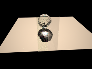

#331243
Aniki wrote:Tom, could you please post the scenefile to this image, and specifiy SL/ rendertime ?
Sorry, I didn't keep that scene. It's just a squashed glass sphere floating on the ground illuminated with a single emitter from above. Let me know if you don't have a satisfactory result by doing the same.
By Aniki
#331262
I didnt get anything close, no caustics behind the glass.
you think that caustic case will be fixed soon ? like working faster and with suncaustics/hdri etc ?
cheers
Aniki
#331264
Sorry, I have to quote myself.
tom wrote:It's just a particular performance issue with sun and small/distant emitters. In your eyeballs scene, the caustics have no problem.
Do you use distant or a small emitter? Maybe that's the case? Please, share your failing scene here.

By Aniki
#331278
tom wrote:Sorry, I have to quote myself.
Well, sorry Lars, for hijacking your Thread, please forgive me.
heres an image, SL was around 31.xx..
and the corresponding scene:
http://www.uglykids.org/ref/MW_Caustic.zip
would be great to have your squashed sphere scene though, just to get an idea.
thanks, and sorry again, Lars !
Aniki
By Lars Magnusson
#331279
He,he, no problem.
Considering the slow progress of my WIP ( guessing I'll be finished around 2031 :wink: ), and that caustics interests me it's fine.
Hm, don't have Maxwell on my work laptop but it looks like your model is a highdetailed displacement mapped object, and the sharp shadows look like they are generated by a sun....the "small lightsource" problem Tom's been mentioning?
By Aniki
#331282
tom wrote:Aniki, your scene has an emitter material but, it doesn't have any emitter geometry. I guess you're using that 1-pixel white HDR image you've sent by the scene and Lars' setup is nothing near to your example. Here, I created anohter scene for you ;)
http://www.fileden.com/files/2009/5/30/ ... _scene.mxs
scene file corrupted...
