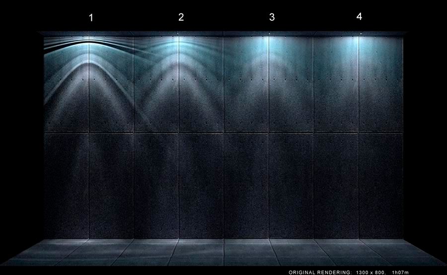

Its very easy to control the visibility of the caustics pattern. This test-rendering shows 4 identical "boris-lamps":
same reflector, same emitter.
The only difference is the roughness of the reflector material:
spot 1: roughness 0
spot 2: roughness 5
spot 3: roughness 10
spot 4: roughness 15

similar thing happens with my led material--higher roughness=more diffuse caustics.
cool thread--anyone try actual lamps yet? the caustics that I've seen so far are way too defined for the type of fixture you all seem to be modeling

I figured out that roughness about 6-7 is the best to use in the reflector, if smooth caustic pattern is needed. You still get the pattern visible, but very smooth already.

Can anyone shed any information about the image on the third page of this post. The one with the colored lights against the concrete wall. My question is this (Whats causing the colored light? Is it a Colored emitter or colored glass lens?) Also are those models available?
#281485
glass lenses are a clear 'NO' in Maxwell.
I recommend not only to look on the pictures, read the posts!
