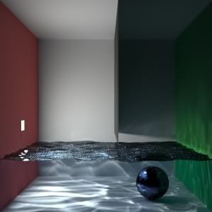

Those reflective caustics are to weak, they're barely visible. I think they should be more pronounced than that considering how rough the watermesh is and how intense the lightsource is.
#266286
Fernando Tella wrote:That's fresnel effect, I think. Set the emitter on the side wall near the water and you'll see much more reflected and less refracted.
I agree. In a cornell box there will be a lot of reflected light - from all surfaces, but not so much from the water surface as long as the lightsource is directly above the water.
new test:
SL=19.7
#266290
new test:
SL=19.7
Great!!

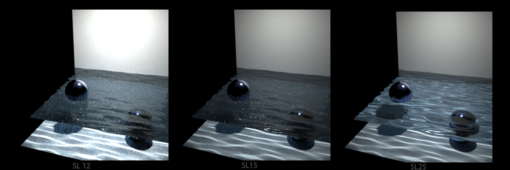

#267300
just a small test to show that real water (dielectric) can show nice caustics trough the water surface if you render to SL25:
300x300px, 9 hours rendertime on my 8core pc...
#267314
Thanks for doing that KurtS. :)
