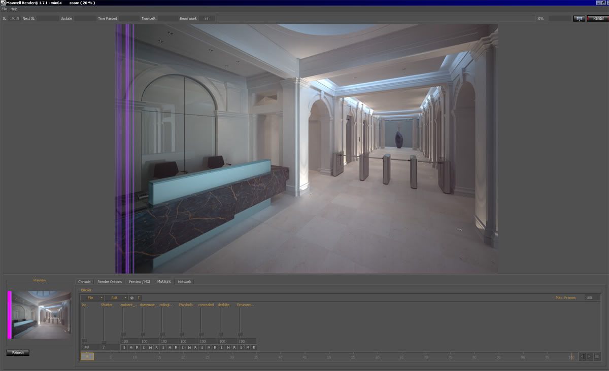

Bit tired of yet another 48hr render yielding yet more memory errors, and wiping the whole deadline in one go!. We will cease using Maxwell professionally until the next version is released.

that's bad news delfix...
if you get these errors like on the image you posted when netrendering(w/wo multilight) i can recommend to do all merging manually.
under some circumstances (hardware/usage) networks can be a big source of errors. this should not happen .. but it does here and there.
merging on a single computer solves these problems.
at least i never had these stripes on single mxi.
i think using a seperate subnet or even a dedicated switch for the nodes is a good thing too.

Hum, it s the same here, a line of stripes of green tilt on a 70 hours renderings on 8 nodes.... we had to flush it in the bin.

1. Is it a network render?
1a. If so, it may be only a merging problem. The 48 hours were not wasted. You can retrieve and manually merge the mxi's. Open each one up and see if there is a "problem" node. This has happened to me before, but only with horizontal lines, never vertical. What are the RAM amounts on each node? Could it be that only one node may be screwing up the whole process?
1b. If not, what was the RAM usage during rendering? I see you have ML enabled. What was the rendered resolution? If it was not a network render, surely you could have seen the problem occurring and stopped the render.
It's only my opinion and you'll probably get mad reading this, but I think you might have created this problem with your process. There's no reason I can see to end up with a final render of 48 hours that looks like what you posted. If it was a coop network render, you could have screen checked each individual node's output at any time during the render. Then if there was a problem with a node's output, you could have killed it's process so that the mxi generated would not be included in the merging process. If it's a single computer's rendering, then surely you could have seen it having a problem early in the render process.
The only problem scenario without a solution I can think of is if it was a single comp render, that looked great until you hit "stop", then the lines appeared. Or upon opening each mxi of a coop render (on the nodes' hd's) you find that all have the green lines.
I'm truly sorry you are giving up on such a great renderer. I hope that you can find a renderer that suits your needs.

Bubbaloo wrote:1. Is it a network render?
...................................Thanks for your consistent help Bubba! but I was aware of all this anyway to be honest. We did manage to recover from 3 of the 6 nodes, but the process took over 4 hours, and the final file is still too noisy. The files are 6.5gb each and take an age to open, especially the corrupted versions. The point is that for the money (and maxwell is not cheap)..... it is simply too unstable. I have used it now for 3 jobs and have had major issues with each job. This is not normal. Furthermore on one particular thread I had raised an issue relating to caustics and what I felt to be a bug in the software. this created unwanted artifacts even when caustics was turned off, and I sent the model to NL on request. after several follow-ups I had no response at all!?!............ I hope NL take note.
Don't get me wrong I think Maxwell produces some stunning results and is a fantastic system thats fun to use. Its just with such comprehensive marketing, and vigorous licensing of multiple CPU's I'd expect more then BETA levels of reliability.
