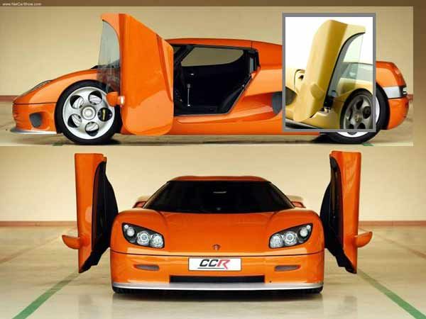

WOW :shock: I really admire your work. what is really bother me that I want to know how are these doors open ?

bugyboo, thankyou. Regarding the doors, the Koenigsegg CCR has the mechanisms I was thinking of:-
At least that is the plan.

yeah.....koenigsegg is a great car...! :wink: waiting for that!
