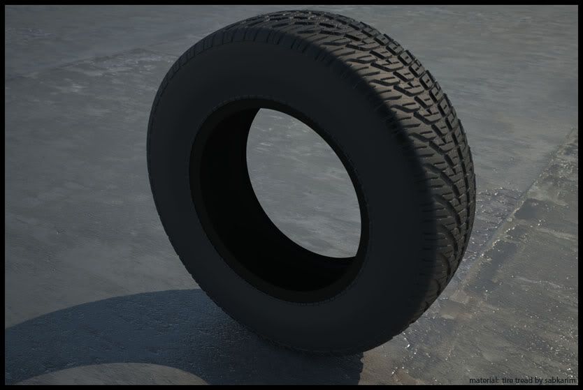

just testing one of Sabkarims materials (he has made a few):

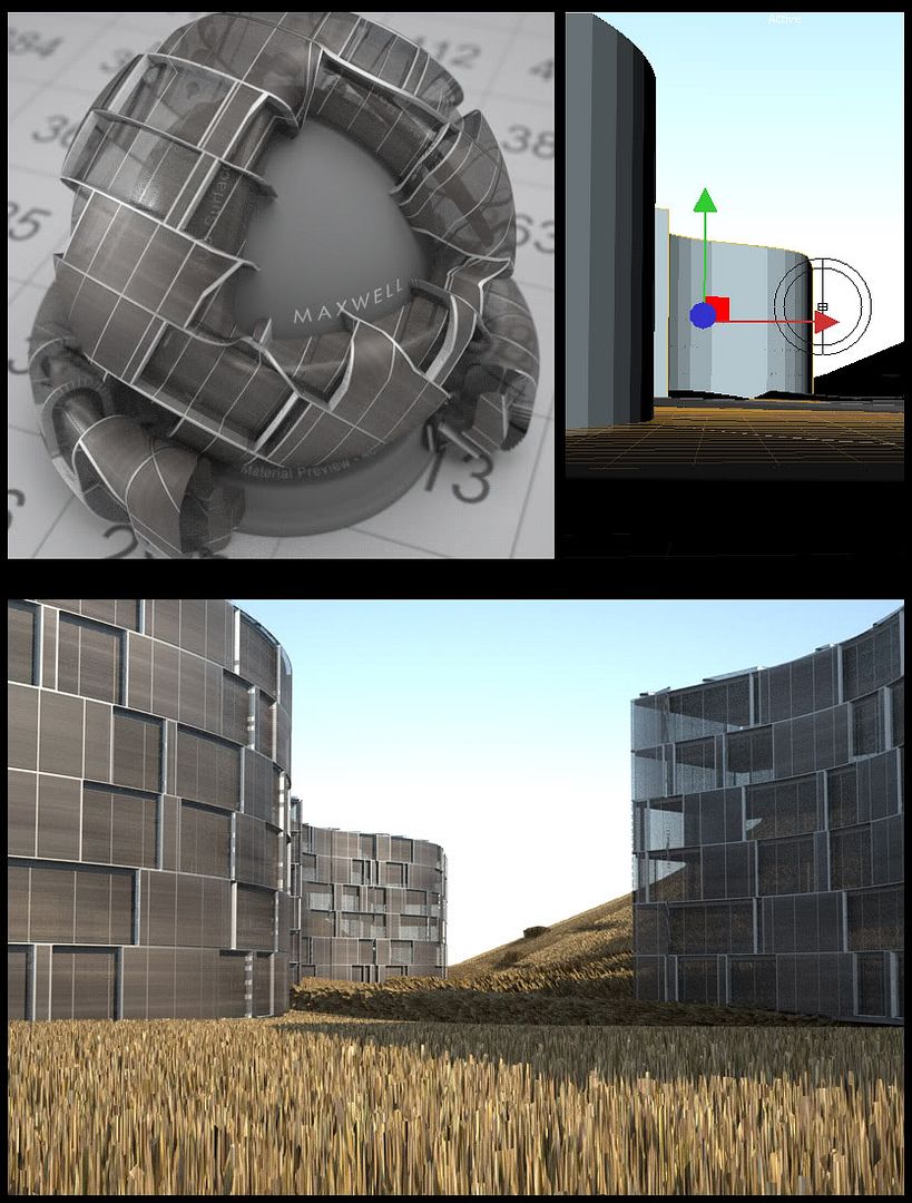

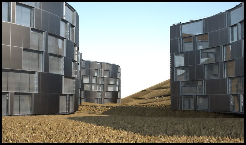

a simple way to create "complex" facades in a hurry...
#268337
I agree with JC, great one Kurt :shock: it looks like you modeled it, kinda hard to believe it's only with displacement.
#268341
thanks Jason and Max.
The displacement precision is actually set very low in the materials in this scene. Precision=8. The secret behind this is of course the density of the mesh.
This means that the material renders fast, and the layered structure makes it easy to change the appearance of the buildings without having to do any modeling.
