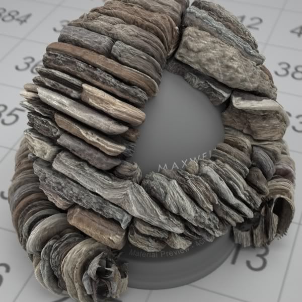

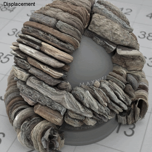

Hi,
Here is a material I've been working on - stacked slate wall. I want to add an extra layer with sparkling tiny cristals which roughly cut stone has, yet I'm not sure that it should be reflective or just very bright layer.
Maximus I've seen your snow material and you seem to have some experiences with making sprakly particles, any suggestions?
Any comments are welcome.
Thanks.
#255810
contact: Nice to see that solved your problem :) and the results look promising, hope we get to see what you're creating there soon.
Pawel: Oh that stacked stonewall looks good already :shock: good work so far! now to create those sparkling crystals in that stonematerial hm, it's a bit difficult as i first of all think those types of stones are quite diffuse with only a minimal amount of specular highlights on them and i also think it could be tricky to create a map that would show up well on that . Anyways, basically what you could try to do is create a map with what would represent tiny crystals of different sizes, greytones and intensities (obviously) and add that to a secondary layer in your material then boost it's nd value alot and add some reflectivity and that's about it.
But if those sparkles will show up that's a different story once you create a scene outta this or use it elsewhere but in the materialpreview render, i run into some issues with that myself today so i dropped the project for today to give my braincell a rest and resume work on it tomorrow. However you may be more successful than me on this, i just think you chose a tough material to add such small barely visible things to. I think they will dissapear in the rest of the colorful rockwall you got there.
Btw, this one is for the contest isn't it Pawel ? :) o and isn't this your first contribution to the displacement thread ? then welcome to the displaced thread hehe

By Pawel Kruk
#255814
Maximus3D:
Thanks a lot for your recognition and tips.
I've been doing some test with particles maps but with a very little succes. You can hardly see it, maybe because of low SL. I'm aware that those sparkles won't be seen from distant view and that's way I want a separate layer which you can turn on for close-ups. I will post some test as long as I get expected results.
...and yes, it will be one of the contest materials I prepare, so you will enjoy it soon :wink:

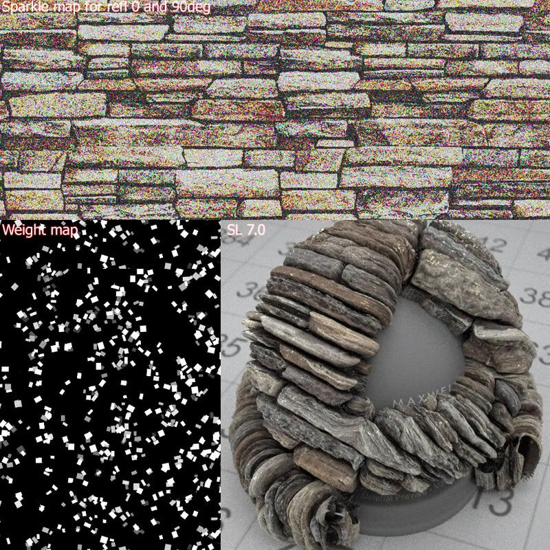

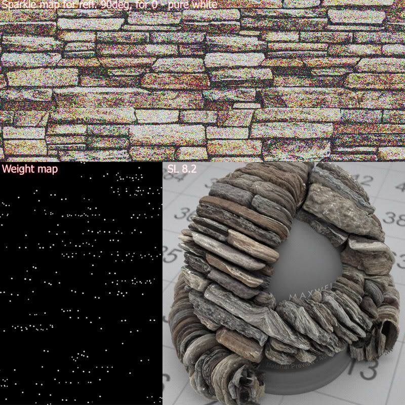

#256418
I'm not a great fun of caviar but your makes me want to try again :shock: . Well done Max.
Here are some test I made since:
To much and disturbing...
This one I found most satisfying.
The problem is that to make those sparkle/mika sharp and shine I need to pump up ND value and lower roughness, but as soon as there is something to reflect (sky for example) which is not bright the whole efect dissapear. Any comments are welcome.
  • 20
  • 21
  • 22
  • 23
  • 24
  • 30
