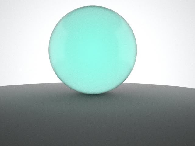

Hybaj, could you expalin you scene setup?
In your last image, i can see a gradient in the background, so this make me think that it tends to something dark...this could explain the black edge around the sphere.
Today i have made many test with some metallic sphere and i couldn't reproduce your problem...even with some roughness. The ND set to 1000 give me a perfect reflection of the background (means no black edge around the sphere).

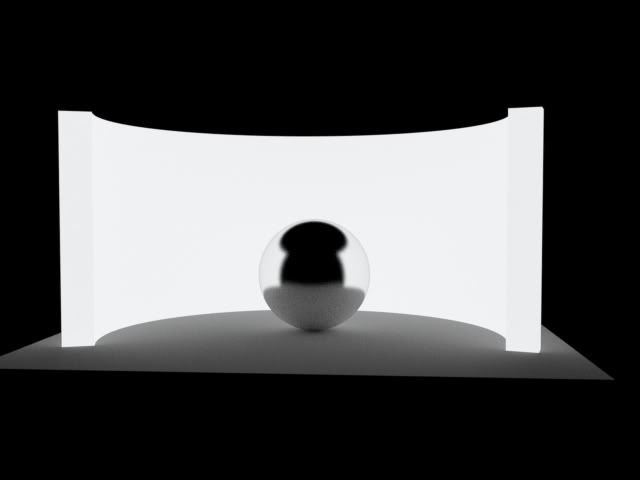

By Hybaj
#277571
Nope.. that's just vignetting (I was turning it off in some previous pictures.. but got lazy) :D I'll pm you with the scene.. you pm me with your scene (but before that render it again and turn down the exposition/iso a bit so we'll be sure it's not the intensity of light that burns the slight fade into total whiteness - because that's why you probably don't see the fade) :D
But speaking of time efficiency.. why bother :D here's the setup :D
And just to make sure that people won't burn me at the stake, i'll put in a picture with a perfect flat background (simple sky dome this time, the last scene setup really did a sliiiight gradient but there was no place on the object that was as dark as the darkest color on the edge of the ball)
#277577
but with roughness=0 and nd=1000 - there is no problem...?
By Hybaj
#277578
The only problem with ND is my philosophical beef with it. I really hate it. I somehow don't see the reason for it to exist inside a renderer.. definitely in a different form... but that's something this whole thread wasn't inteded for :D
Now the problem with roughness and reflectivity is somewhere between the method used for "roughing" up the surface, weird angles, and fresnel law. It's a problem only solvable by some coding. Glossy transparent materials look damn good after the fix - well they just look real without any abstract edge darkening (the "low" ND dark edges also look very abstract) :P

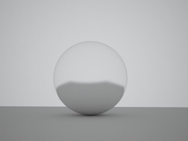

I have done many others test to try to find how you get these results and now i can reproduce it. However i think your setting to tend to these results are not accurate and realistic. You will see at the end of my battery of test in my next post that there is a solution to your problem.
By hyltom
#277624
Skydome used for lighting (please for all these test don't pay attention to the maxwell material preview...the picture was not updated...forget to do that)
Test 1
Test 2
So on the test 2 it's obvious we can see the dark edge when there is some roughness applied to the material or when the Nd is too low. But i think this material setting is really not representative of a metal....anyway we got the black edge.
