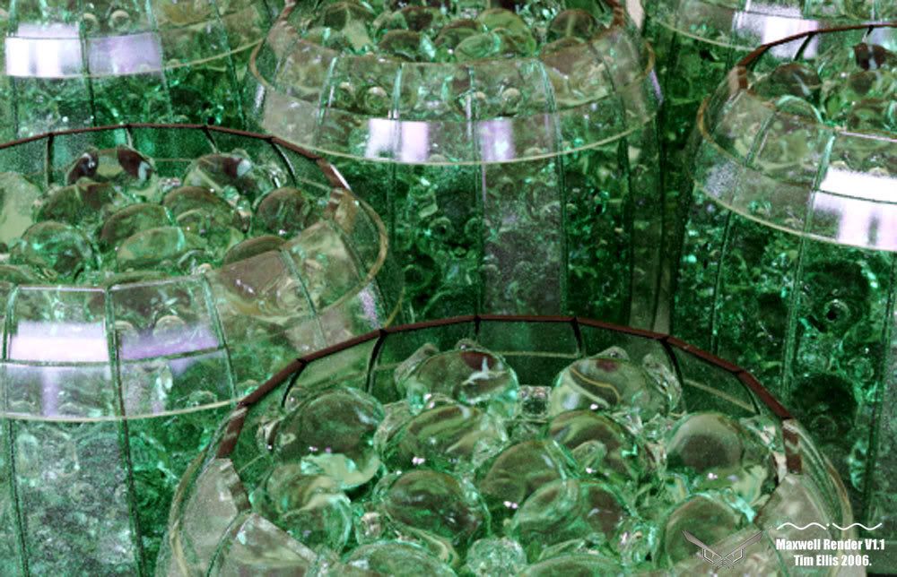

Update:- SL16.67 merged co-op renders. Total render time at about 17hrs.
Zoom :arrow:
MXS file is 300MB without the HDRI. :shock:

Tim Ellis wrote:It is re-rendering now whilst I'm at work, with the indirects on, but with no noticeable difference. I didn't turn off the master indirect reflections/refractions, but turned them off in the indirect caustics box. This is why I don't think they turned off.
Since they don't affect rendertime, you should activate all and they would effect such setup dramatically. It's hard to compare the difference though but it's theoretically there and practically makes sense with higher samples.
Tim Ellis wrote:I placed them by hand and some are intersecting, if not all because of the ears.
Rendering of glass-glass intersections are technically not possible. This is something you should avoid. It would always return you unwanted results and maybe those odd dark areas could be highy due to those intersections. See if you can prevent this.
Very nice update btw! I would like to know your dielectrics setting and I might have suggestions depending on what they look like.
#187441
Cheers Tom. I'll have a play with the mesh and cut off the ears.
I've spotted a few eyes that are intersecting with the barrel, so I'll tweak these too.
New 17 hr render has pushed the co-op SL to 17.7. I'll upload this with another render that's running tonight and set a new refined version rendering tomorrow night.
The glass material is the wizard standard glass. Purple (Maxwell assigned) 90' reflectance and green transmittance. I'll try to post a MXED screen shot tomorrow.

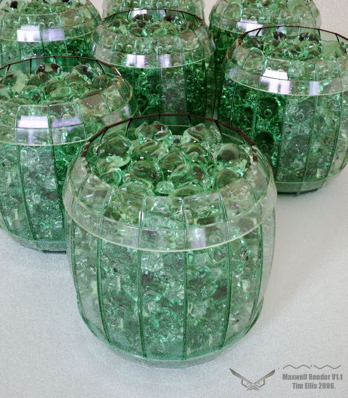

Update:- Note 'Suzanne' is the name of Blender's primitive monkey head mesh. A variant of the tea pot thing.
Material test.
Material setting.
No barrels.
The eyes are black because Suzanne is three joined meshes and I forgot to duplicate the eyes.
The nearest head has eyes still in place and you can see the refractions clearly.
The eyes need to be joined to the head, which I've now done. (Thanks Tom.)
Last of the incorrect mesh version. SL18.19 Nearly 48hrs of combined rendering!
I had to remake the whole Suzanne mesh, because I didn't want any intersecting mesh objects.
New version tomorrow.

8.5hr render SL13.5 BM 8.2. 5.95million tris. No intersecting mesh objects, at all. Not one. Zip. Nada. Nowt.
I think I prefer the original, the errors seem to give it something more than the new version.

Hi Tim,
The glass material is not optimal. The attenuation is too high and that is why you see no contrast (dark areas).
In your shoes:
1. I would click on the transmittance color and set v = 250
2. Click on the Refl-0 color and set v = 5
3. Set attenuation = 3 cm
Using the above as a starting point if the glass is too green then decrease the saturation (say s=50) for both transmittance and reflectance0 colors, but leave the atenuation at 3cm (which should be a constant for common glass)
So in your case you could try:
Refl0 = HSV (139, 50, 250)
Trans = HSV (319, 50, 5)
Att = 3cm
#187783
