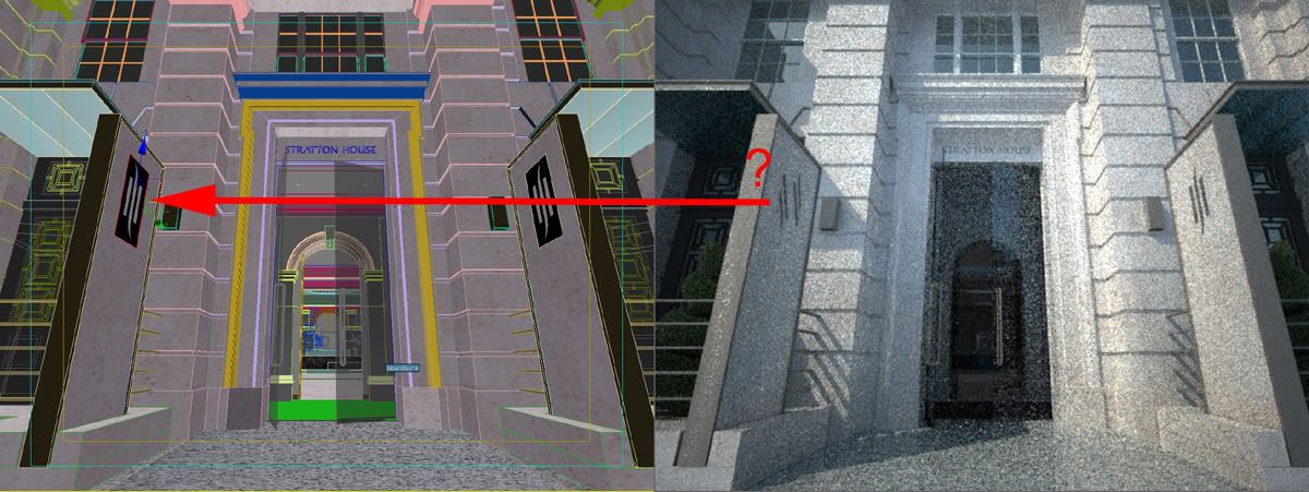

Hi,
Having a very frustrating time getting the UVW coordinates to translate to MXS for some reason. Never had the problem before. Ive even copied the plane on the right over but the problem persists. Any ideas?
thanks
By Bogdan Coroi
#277794
I guess that's a mirrored plane. There were some issues with the mirrored objects in Max. Try making a plane without mirroring. Also, could you send me the scene with only the 2 planes so I can debug it? (bogdan.coroi@gmail.com)
By deflix
#277853
indeed it was mirrored - thanks for the tip.

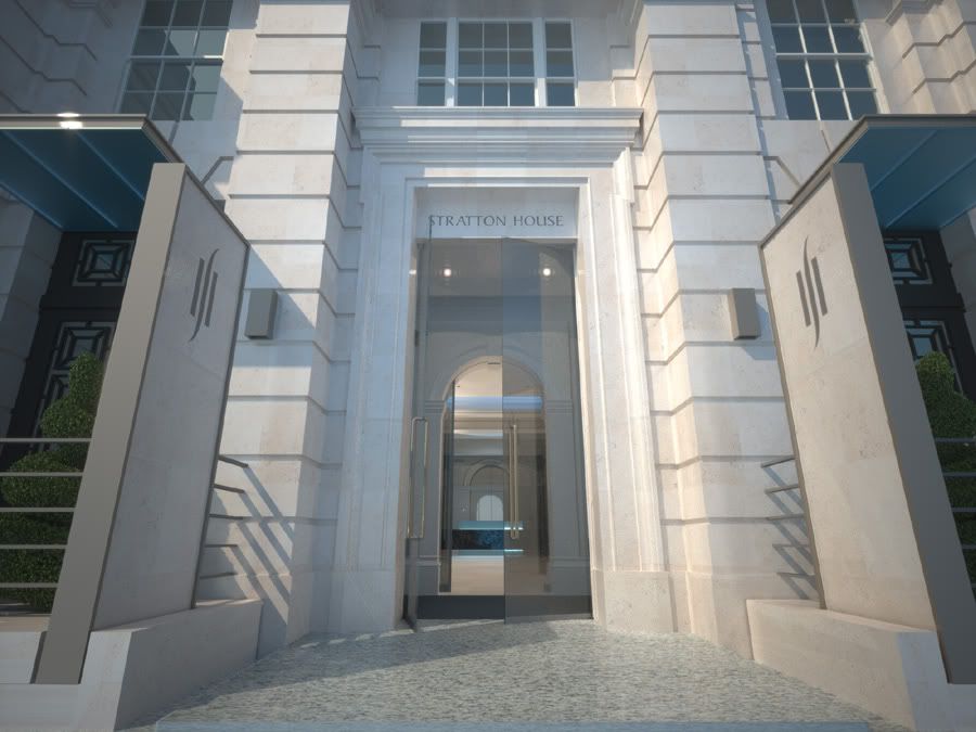

.......maximus - thanks for the comment - latest render below ... still getting my head round maxwell!
