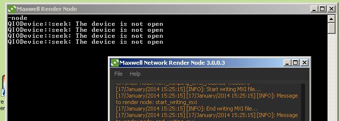

Ok great, so to recap this last part (doing this especially for Juan so he can see a quick summary and problems of your last posts):
1. Starting only Monitor, Manager and one Node:
"the node in question still shows this second MW cmd window:"
http://www.maxwellrender.com/forum/view ... 21#p376821
Does only this particular node show that cmd window, or all the others as well?

Mihai wrote:Ok great, so to recap this last part (doing this especially for Juan so he can see a quick summary and problems of your last posts):
It took me a moment to realize the other points weren't questions.
Regarding your question:
ATM no node is showing it.
Before always one or two were showing the CMD, not necessarily always the same ones (after a restart).
The nodes are still rendering. The monitor stopped updating after they each had rendered ~ 4 frames.
But the nodes are still rendering and writing the MXIs without a UNC path.
BTW I am rendering to my shared windows drive, not to the NAS.
