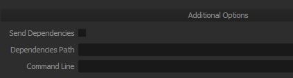

This job was exported from Cinema4D to the NAS with Pack&Go enabled.
I did NOT enable "Send Dependencies".
Setting a dependencies directory does not change anything.

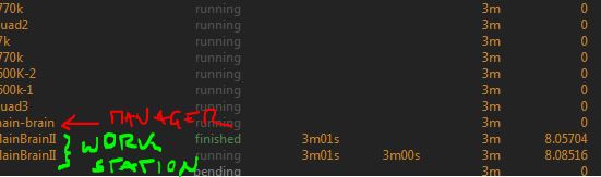

Result:
The Node on my Work Station is rendering, all the others do not.

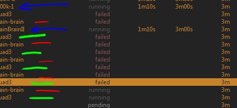

This is a screenshot from the machine with the Manager:
#376672

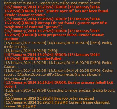

Now with "Send dependencies" enabled:
The nodes started working (blue) except two of them (green and red) who could not find some textures the others could find.
That is the red Node:
Juan, should I post the Nodes log file here?

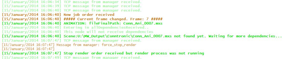

I had a peek in the Node's log file.
This part is from the "Send Dependencies" DISABLED:
The Node was assigned frame 7 and did wait for the MXS file. After a Minute I stopped it:
In this screenshot from the Node the file clearly is accessible:

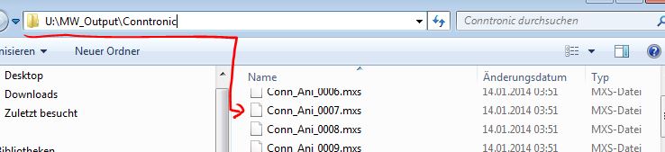

To test whether the NAS is the problem I set one of the drives of my work station as network drive.
It is drive G:
I connected this drive G: as G: in all render slaves.
Then I exported the animation from Cinema4D with Pack&Go
I saved it to G:\Conntronic_Animation
Maxwell saved all MXS' in G:\Conntronic_Animation and created a subfolder "textures" with all textures in it.

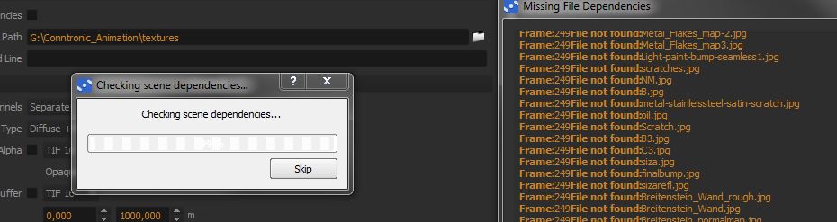

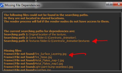

I started the Manager and the Monitor on the work station and created a job as "Animation".
Result (and it doesn't matter whether I set a path or not):
So I opened frame 0 MXS in Studio ... oh - look - Pack&Go did work:
But Missing File Dependencies check disagrees:
#376684
Mihai wrote:But that doesn't seem like a UNC path? It should look like this: \\computername\folder\myfile.mxs
When you browse to the mxs file, in the explorer that appears you need to browse through the "Network" and browse to the shared folder.
I NEVER did that?!
Not in MW1 or MW2 and certainly not with C4D or Vray.
This is a completely unusual way of working for Windows.
I don't know if you work with Windows, but there you have letters assigned to drives.
So all network clients connect to folder "test" on the NAS under U:\test\
EDIT: Could someone using Windows and MW in a network please weigh in?! How do you save and open MW's files?

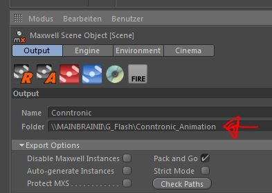

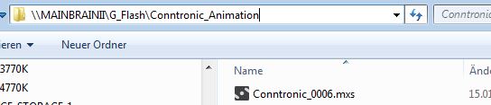

Edit: I will try saving with Pack&Go to "\\MAINBRAINII\G_Flash\Conntronic_Animation"
We will see ...
#376692

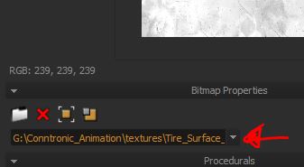

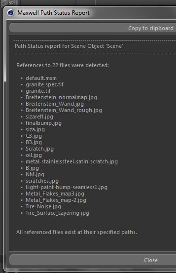

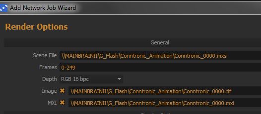

Well, I exported to an UNC path:
The texture check is ok:
I checked and all textures are saved under "\\MAINBRAINII\G_Flash\Conntronic_Animation\textures"

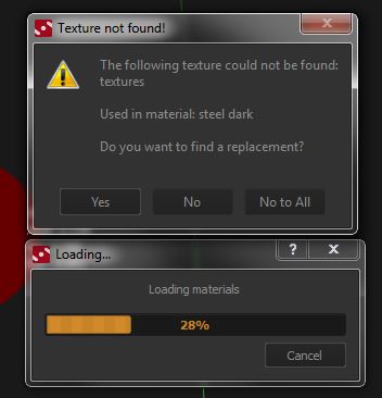

But Studio says:
The funniest thing is: "steel dark" doesn't even contain a texture ...
Now on to the Monitor ...
#376695
I've been working on figuring out that bogus missing "textures" thing for awhile; hadn't noticed it exporting from Cinema yet, but from SketchUp. Aside from making you want to click "No to all" when you maybe shouldn't, I believe it is harmless, and indicative of nothing. At this point, it seems somehow related to the active texture in the material, combined with the plugin's writing of relative paths to the MXS when Pack & Go is enabled.

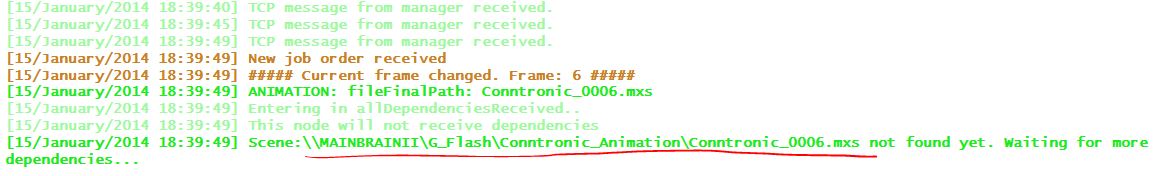

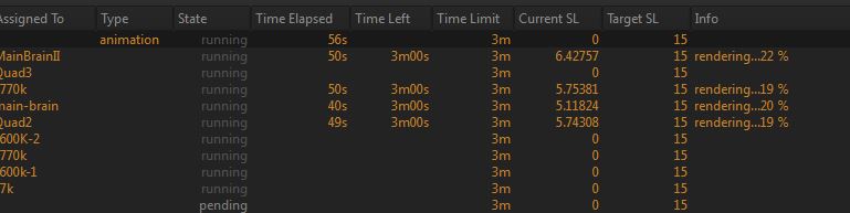

Monitor settings:
RESULT: Only 4 Nodes are rendering
One of the Non-Rendering-Nodes shows this (and, again, stays that way):
The Node has full access to the network:
Its log file:
The same as before only with an UNC path ...
And again - there it is:
#376698
JDHill wrote:I've been working on figuring out that bogus missing "textures" thing for awhile; hadn't noticed it exporting from Cinema yet, but from SketchUp. Aside from making you want to click "No to all" when you maybe shouldn't, I believe it is harmless, and indicative of nothing. At this point, it seems somehow related to the active texture in the material, combined with the plugin's writing of relative paths to the MXS when Pack & Go is enabled.
I believe it to be harmless too, as all textures were found both in C4D's check and the Monitor's dependencies check. It is not even a real texture name. In a material that does not use textures.

#376700
zoppo wrote: The funniest thing is: "steel dark" doesn't even contain a texture ...
It only happens with materials without textures for me (exported from Sketchup as JD says). You can simply hit "No to All" and it opens correctly - as "workaround".
#376702
numerobis wrote:It only happens with materials without textures for me (exported from Sketchup as JD says). You can simply hit "No to All" and it opens correctly - as "workaround".
Thanks, but I used Studio only to verify that Pack&Go set the textures' paths to UNC. It did ;)
