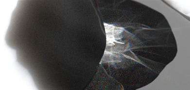

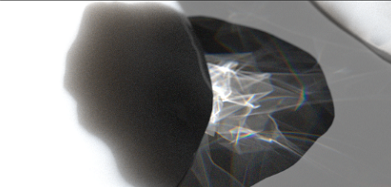

As you can see on the top images, they both are at SL 25, BUT merged from coop.
I am currently rendering on a single machine to the max.. but at SL 20 currently no caustics on/in the sss volume..
By Aniki
#382615

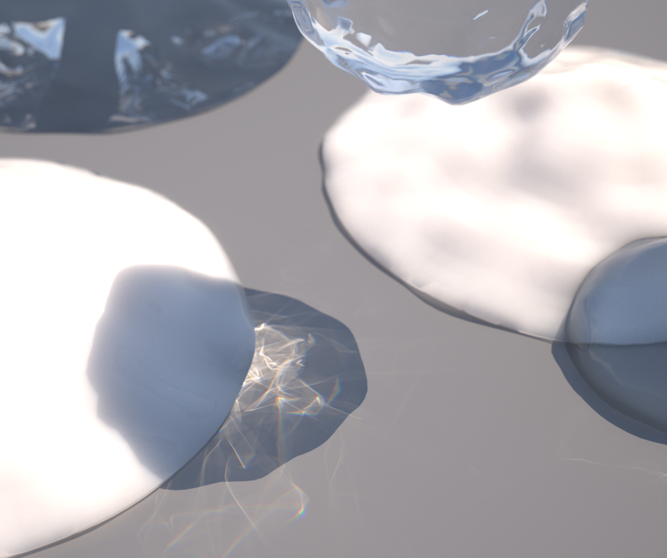

Mihai, I did, its the second image on the first post. Besides some rough noise, which is scattered like fireflies across the whole volume, I don't see caustics clearing up, do you?

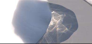

to summarize, I am rendering 4 different setups now, and currently it doesn't look like any of them is solving the issue. (yet two arent on a sufficient SL to tell for sure).
1- inital sun caustics approach
2- inital light caustics approach (far away)
3- adapted sun radius to 10 as suggested by Fernando
4- adapted light radius/distance/strength as suggested by Mihai

Updated my post before with the respective results, first is at SL 23, the others around SL 16-17.
Eric, its not about speed, I am completely fine for this test to take time, its about the natural/physical result I am missing here.
I already took photos of milky fluids and caustics, evenly spreading from the ground across the fluid surface as you would expect to happen.
