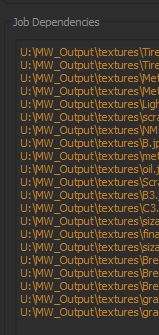

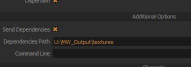

Confirmed. The workstation and some of the nodes are running Win7 pro x64, some of the nodes are on Vista x64.
"Send Dependencies" enabled:
The "Dependencies Path" setting is ignored (U: is the NAS)
"Dependencies Check" shows the texture path on the local drive F:
Nodes are getting the textures and are rendering.
"Send Dependencies" disabled:
"Dependencies Check" shows the textures in the NAS path.
Nodes are not rendering.

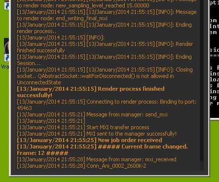

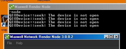

Meanwhile one of the Nodes shows this:

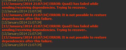

Again ...
It's the same Node (Quad3) as above.
The Node has crashed and the Monitor says:
I restart the Node and it says (and stays that way):
Meanwhile in the Monitor:
ATM the Monitor is still updating the other clients.
Edit:
The Node still shows this second CMD window:
It is the only node who does this.

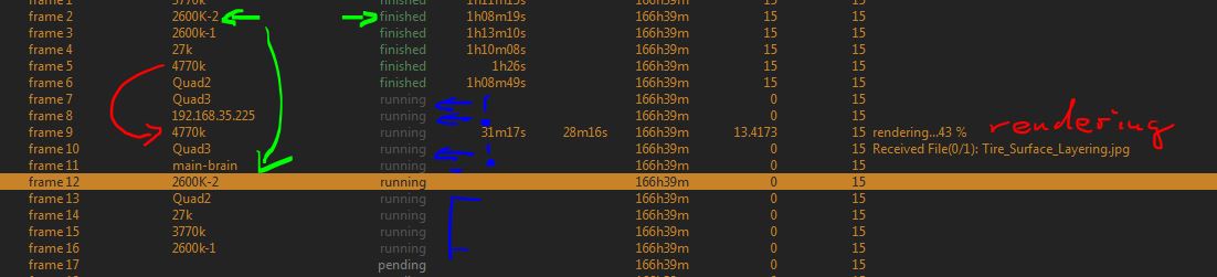

The Nodes grabbed a new frame - and this happened:
Quad3 is 3 times in the list (blue !)
2600-2 (green) and most of the others say "state: running" but don't do a thing:
4770 (red) is the only one who got to his second frame and is rendering!

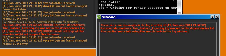

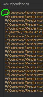

And Quad3 doesn't like the dependencies all the others took for the first frames:
ADDITION:
I restarted the Monitor, nothing changed.
Then I reseted a Node from the Monitor's node list.
The Node stayed in the list and was listed in the job list a second time under his IP address.
It did say it had a new job assignment but did not render.
Then I closed the Node manually and restarted it manually. Now it shows the same dependencies failure as Quad3.

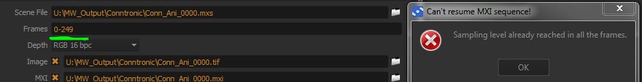

PS: After stopping the job this happens
