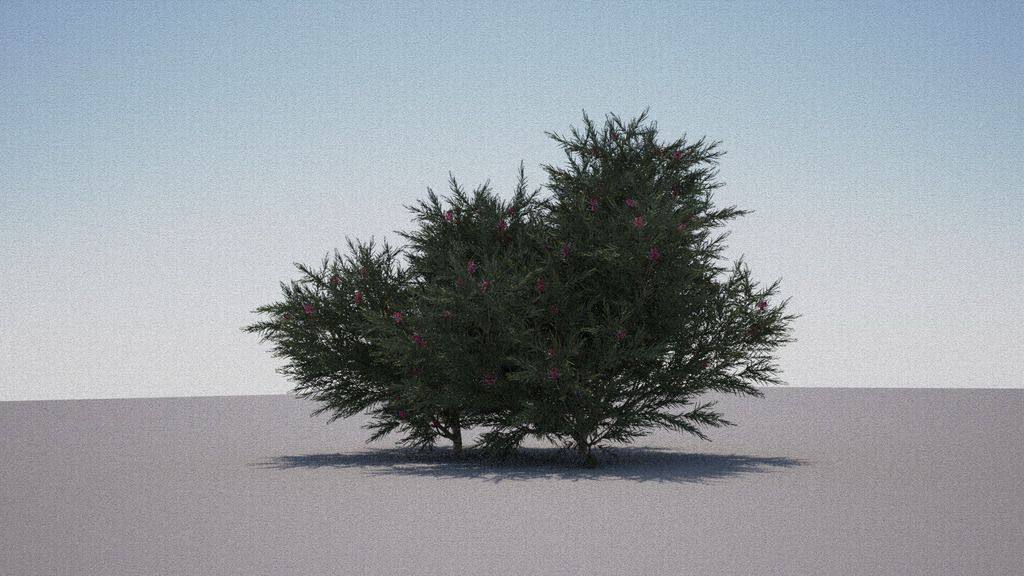

I have a small plant that I purchased from XFROG. On my 40 core work station it has a benchmark of 36 and says it will take 5 hours at 12 sl to render this small bush......

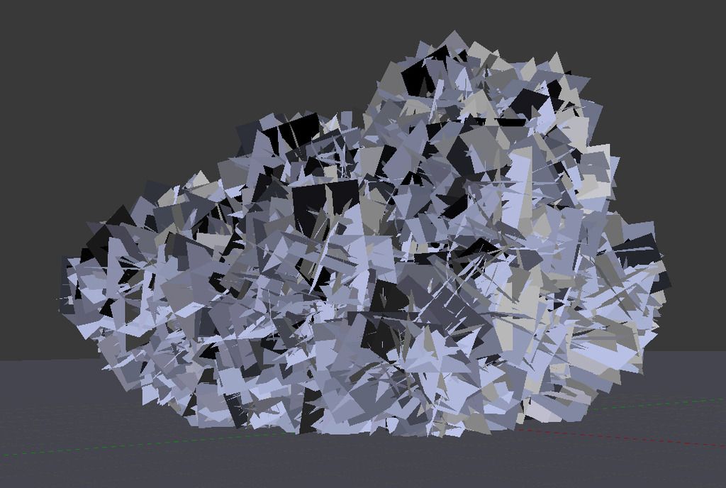

Here is a short render only to 5 sl and a screen grab of the model.

It will always take ages, try to make as small leaves as possible to leave very small transparent area. Sometimes it's better to make geometry leaves, it takes more RAM but will be rendered a lot faster.

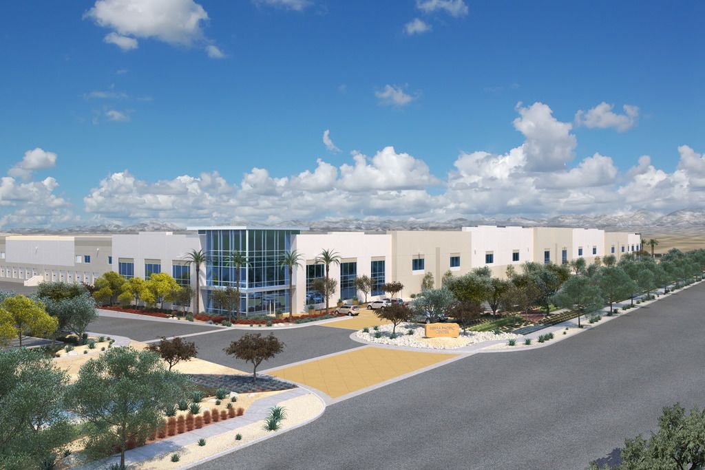

99% of all my plants are actual geometry with no alpha masks. I just needed a rosemary plant quick. So I bought this from xfrog. I wonder why they make them like this if they not optimized for some rendering engines.
This is the scene I am working on. I have one tree in here with transparent leaves, no intersecting. The rest trees and plants are a geometry with no alpha maps.
The mountains are geometry, to scale, 31 miles away.
Renders fine on my computer. 3600x2400 9 hours 15 SL.

As noted I agree it seems the problem with this particular model is the planes are so big AND heavily intersecting, compared to what will actually be visible in the end. Lots checks Maxwell has to do "for nothing", when a more optimized model would have the leaves cover most of the texture space and only a very small area would become invisible.
