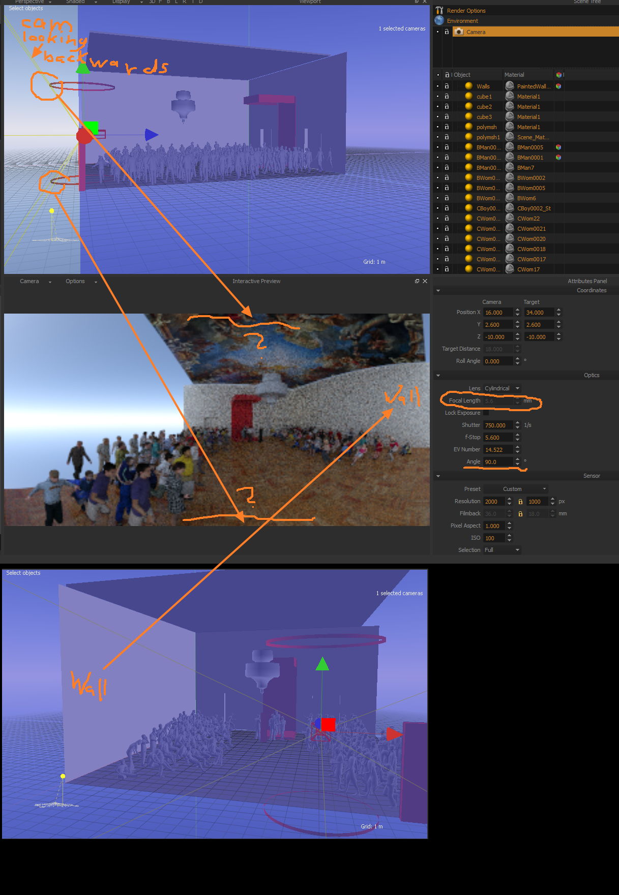

Hi,
running a V3 Demo, in the cylindrical lens option i didn’t find a way to setup a vertical FOV. Didn’t see a parameter for it. Checked a few points but wasn’t giving me control of vertical FOV yet:
* Changing the x-y size relation in the render resolution.
* Focal Length is grayed out, guess it’s replaced by the Angle parameter for the horizontal FOV.
* The Angle parameter in my case needs to be set to ½ of the targeted value to function correct (setting 360 degree = shows 720 degree, 180 deg = shows 360 deg etc.)
* The scene seen through the cylindrical lens in Maxwell Studio appears flipped horizontally.
* One more thing is that when using a 180deg angle (set to 90 to receive 180deg), the camera looks backwards. When i rotated it by 180 deg. in y-axis, i got the forward view.

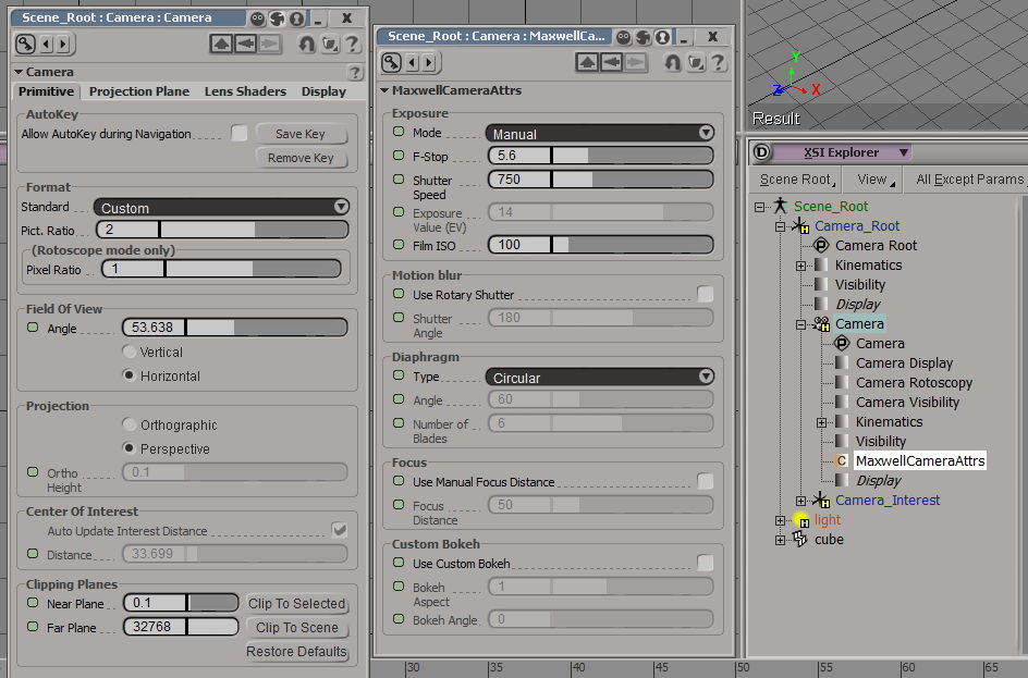

* Is there a softimage plugin V3 version in the works to use Fire in SI with different lenses directly ?
* Is there new command line options for using the different cam lenses yet ? I’ve checked http://support.nextlimit.com/display/mx ... mmand+Line but didn’t find a full V3 list yet that would carry the lens-types for example.
Regards,
Frank
