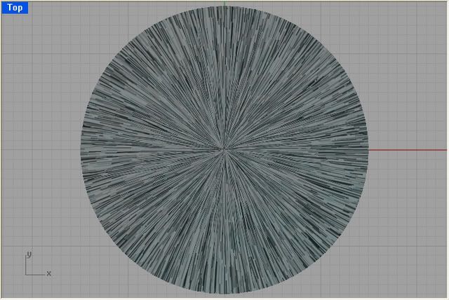

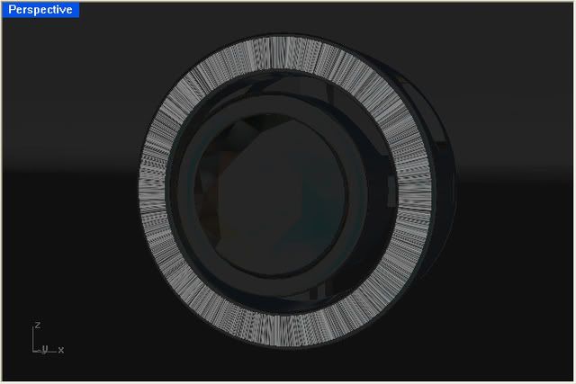

I'll fiddle with it and see if I can figure it out! So far I have just been using regular materials and just applying them to my models. This texture mapping and swapping UV's is like Quantum Physics to me!!!Thanks again

if you apply any texture in rhino, surface UV mapping is default.
It is a feature of nurbs, that they have " built in " texture coordinates, generated from how isocurves are distributed along U and V surface directions.

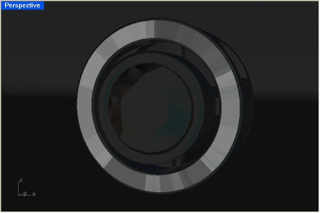

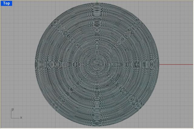

if your surface is revolved, untrimmed has surface mapping and with controlpionts on looking like something like this:
it will be good.
By caryjames
#267226
That did it! I have the object rendering right now and will post the finished render, thanks so much for taking the time to help out!!!
