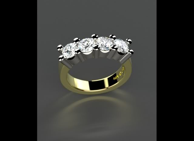

Thanks JD I got it! I am still not chuffed about the results though. I am trying to render jewellery and just ordered some of the hdri's from hdri studio. I will use the idea of an .mxi added to an emitter for the future though.
2 hours later........
I just finished rendering a scene with an hdri!!!! Boy did it turn out better than just using straight emitters. Thanks again here is the image, any advice, tips, criticism is welcome!
