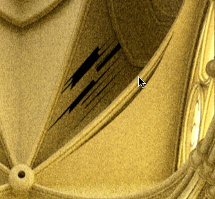

However, I have the same problems with a scene, and all the above
reasons are not responsible. Looks like this:
This exact scenes rendered fine with the plugin versions Alpha, Beta, and RC5.
Now with V1.0 they fail. They did so in C4D 9.52 and C4D 9.6, so I would
rather not assume that it was the version change in Cinema causing this.

With suboptimal modeling I didn't meant flipped normals and such thing I've
mentioned above, but especially elongated polygons.
You can get there quite easy with primitives or lathes. And it happens quite
often when working with CAD data.
As long as you calculate with the necessary precision, this is not an issue.
I'll try to isolate the cases that I have, check them in Studio and post
them here. Could be the plugin causing this mess here...
Kabe

seco7 wrote:That's interesting Kabe, do you mean subdivide an object and it should fix the problem?
No, subdividing elongated polygons will create even smaller elongated
polygones. Cutting *might* be an option, subdividing certainly is not.
However, IMO this is not a viable option:
It renders fine in *every* renderer except one, so it smells like a bug to me.
Kabe

I used subdivide and the problem disappear!!!
I' am working on a building, two cases and going. On both of them subdivide solved the problem.
