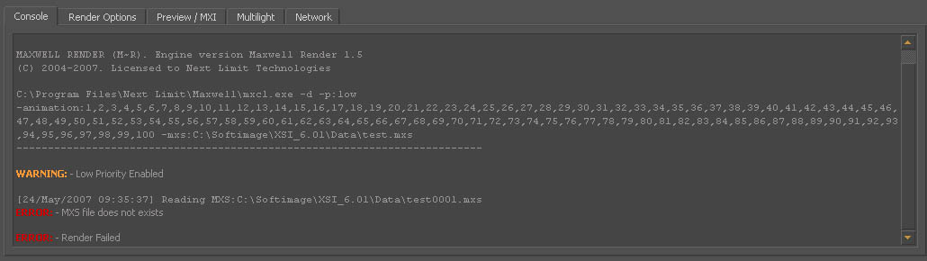

Whenever I try a preview or render, the Maxwell Render UI pops up and from the console I can see the first thing that happens is that Maxwell creates a MXS file, the very next message in the console is that it cannot find the MXS file and then aborts the render.
However if I go to where Maxwell said it created the MXS file, I can double click on it and it will render fine.

Here is a screen grab of the console.

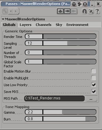

Could you post a screenshot of the Maxwell render options panel? Is your "MXS path" set exactly to "C:\Softimage\XSI_6.01\Data\test.mxs" or is it missing the extension or something like that?
It's trying to render an animation, which means that it expects to find multiple files called "test0001.mxs", "test0002.mxs" etc. Do you have a single file in the "C:\Softimage\XSI_6.01\Data" directory?

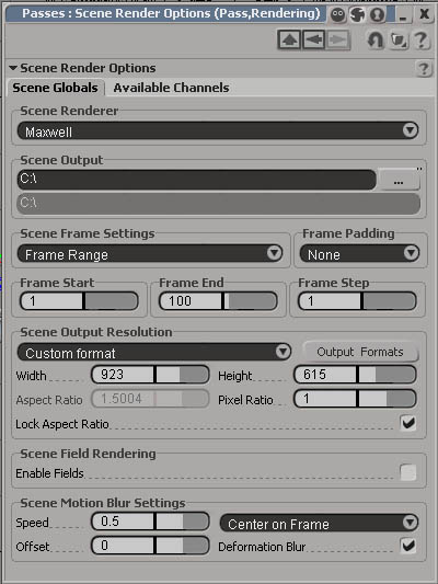

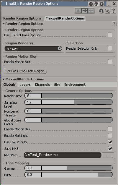

I've simplified the path right down to just the "C" drive, still the same errors, either at render region or full render.
Scene Panel
Region render panel

Um, your MXS path got one too many slashes in it (i think). Try to remove one and see if it helps..

Region rendering is not supported properly yet, it will be added in a future update.

The extra slashes shouldn't cause any trouble, but try without them anyway as Maximus3D said, just to make sure.

Maximus3D - XSI creates the extra "\" automatically, although it creates the MXS file in "C:\Test_Render.mxs"

SORTED - with the help of Mihnea.
In XSI's Render Manager, the default setting for Pass Frames is "Use Scene Render Options", if I set it to "Frame Range", then all renders fine.
