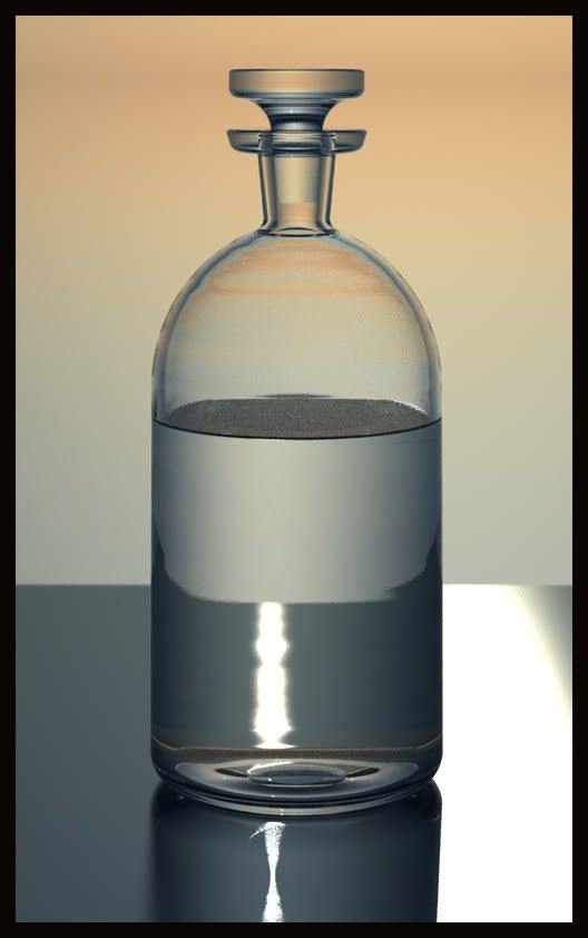

#275792
a 15 minute rendering of a bottle with water using Thomas' method:

MS wrote:The thread is pretty old now. (ALPHA - 1.1.33 - May 20, 2005) Are there any changes?
Some things that are different now ( although the overall result is the same as before in regards to liquid+glass):
1. A ray passes through a solid only if it encounters opening and then closing normals of the same mesh. Unlike in the past you can no longer have separate meshes (now you have to merge them to be considered a solid)
2. Rays passing through a stray single plane (non solid) will always cause refraction regardless of the direction of its normals (unlike in the past).
The method of the old thread still works in 1.7 as long as you keep the glass as a solid (I can say it with certainty for dielectrics only ... I am not yet sure what is happening with SSS)
